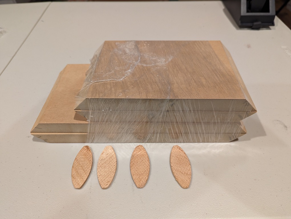

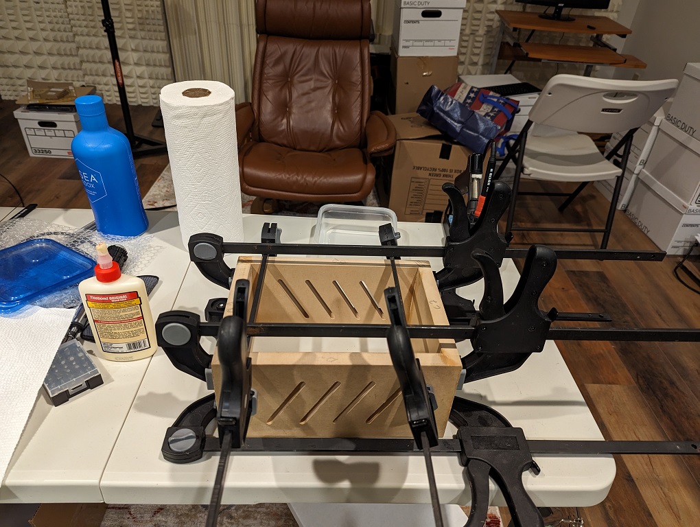

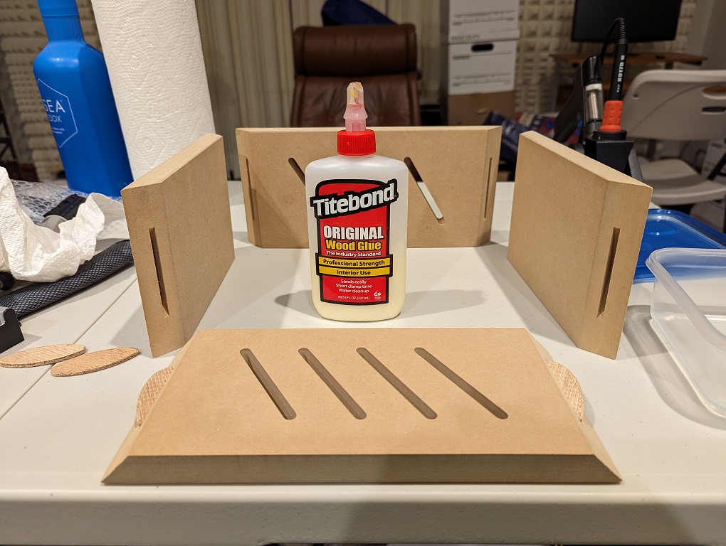

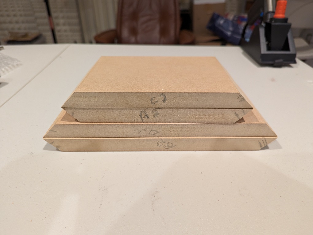

The servo amps need boxes, so these are captainhemo's HX style flat pack boxes.
Box #1 it glued and clamped to dry.  Then on to box #2 assembly.

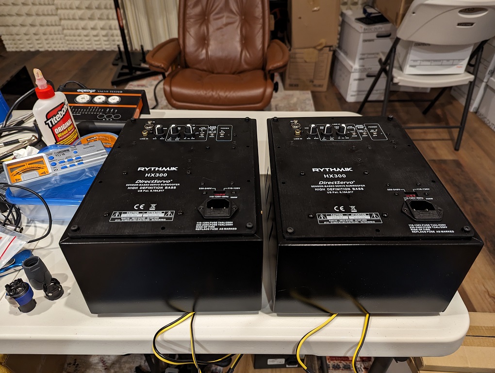

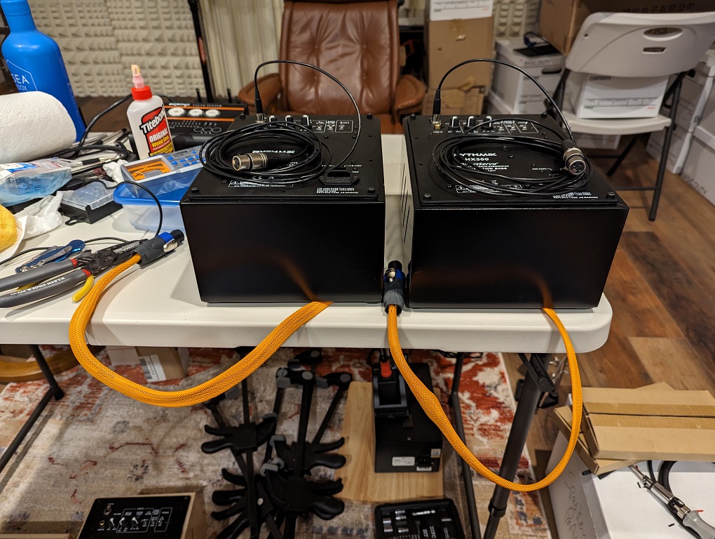

The custom modified HX300-8OB servo amps are here and now in their boxes to get wired to the servo subs.   This is not the original HX300-8OB.
Using the Neutrik 4-pole Speakon connectors on the cabinets and wiring harness for simple connections.
Wiring the cable harness is ongoing as the parts arrived today to complete the wiring.
The 4x8in OB cabinets are to be finished this week and delivered.
Getting closer!

« Reply #31 on: 22 Oct 2023, 02:06 am »
The servo amps are wired and ready for testing.
Next step is to wire the cable harness to the individual modules.

On the speaker side of cabling, why not put terminals in the wood box so customers can use whatever cable brand they like/have clean looking wiring?
HAL
Re: New 8in OB H-Frame servo subs cabinets
« Reply #34 on: 22 Oct 2023, 11:44 am »
The latest version of these amp boxes can have the Neutrik connector mounted in the box.  The wiring is directly from the amp board without any other connections before the cable.  This was just convenient to put the Neutrik connector on the existing cables.
These are early versions of the mounting boxes that did not have the mounting hole drilled.  They can be made with or without the mounting hole.
The servo amps requires a 4 wire connection to the servo sub drivers for the servo amp to work correctly.

« Reply #35 on: 23 Oct 2023, 06:37 pm »
The HX300-8OB servo amps are wired to the two sets of 4x8in servo subs.  They are now working as expected.
The finished 4x8in OB H-Frames should be here on Friday to finish the install of the drivers and wiring.

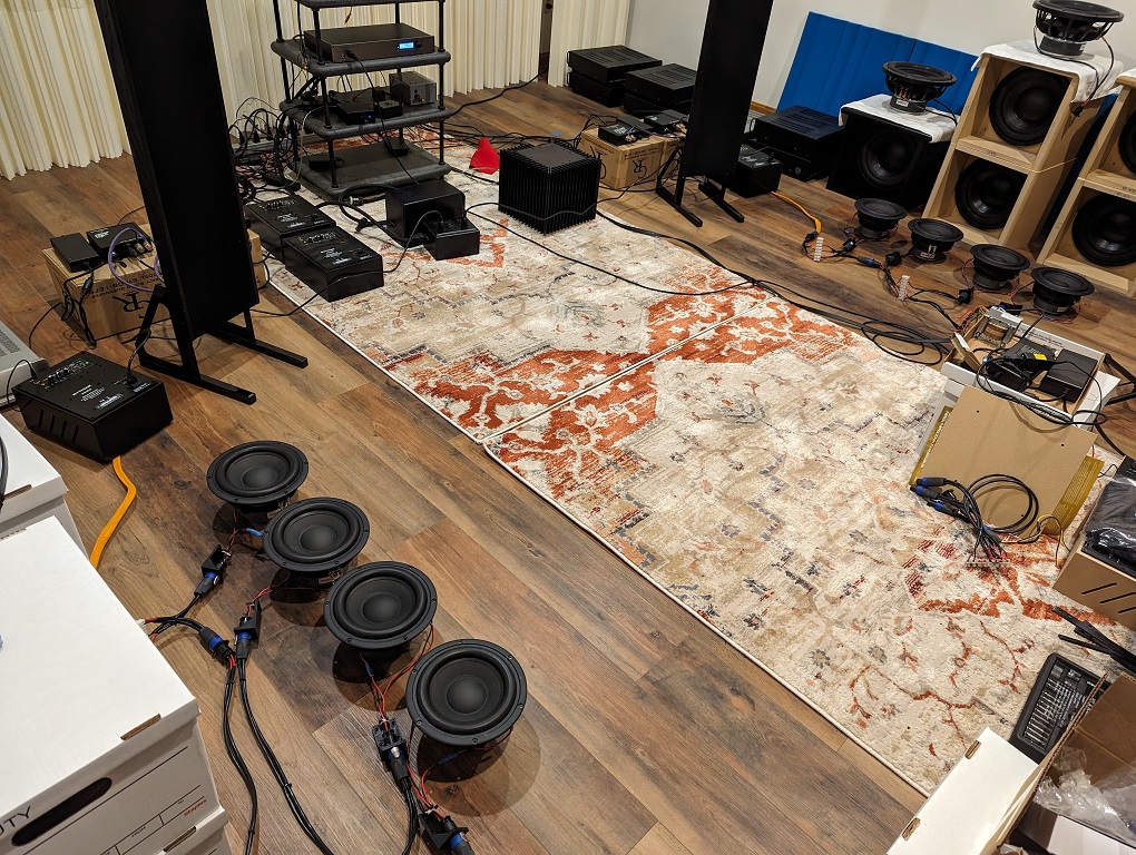

« Reply #36 on: 23 Oct 2023, 07:09 pm »
That room looks like an audio laboratory.  Love it!!
HAL
« Reply #37 on: 23 Oct 2023, 07:24 pm »
Tyson,
It is an audio lab.  Wait until I have the two new 6x12's servo subs built and take two more 3x12's to the rear of the room! :o
