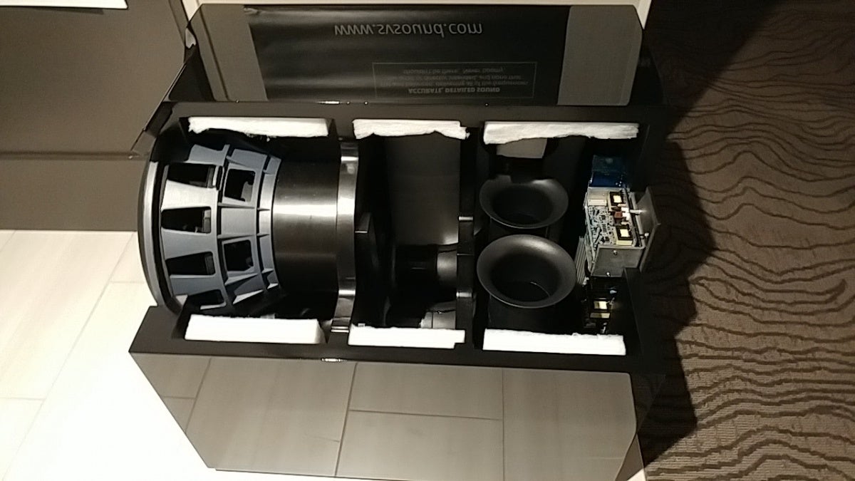

I have and love the GR ob subs and heavily endorse. I will also actively malign the SVS subs; folks talk them up, but I had dual SB-4000s and they were awful. REL makes great subs and would be my first and last stop if not doing a DIY kit with GR.
This statement reminds me of the time (over 20 years ago) when I initially joined an audio forum and SVS subs had entered the market. Everyone praised them. I went to hear a friend's home theater system with an SVS sub and it sounded awful. I was dumb (or naive?) enough to say that as my initial post and they damn near ran me out of there. Turns out that the original SVS subs had zero bracing!!! And boy, they sounded like the drivers were bouncing around inside the cabinet. Just awful. I learned three lessons from that experience -- the masses don't have good ears, don't believe the hype, and speak the truth even though you'll probably get flamed for it.
