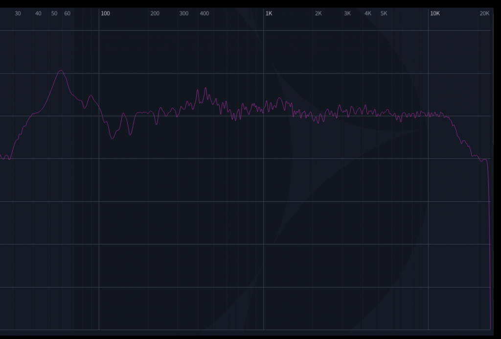

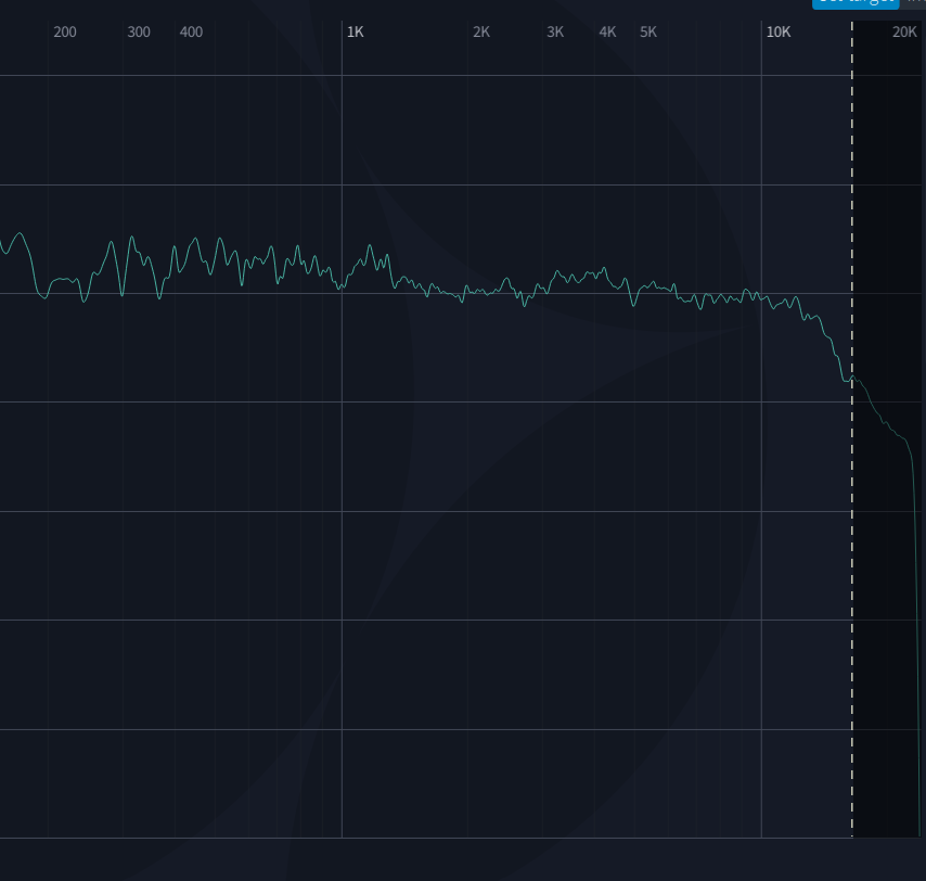

So tonight I broke out my Umik and graphed the in-room response of the GR Brutes at 75db while connected to my ST-70 tube amp. Each of the major horizontal white lines on the graph is 10db. I recorded this in a small listening room at my listening position and have a significant room mode at 80-100Hz and as that is a room effect, I have filtered that from the graph as its not true speaker output.
The rest of the in room response looks pretty dang good to me.
The HF roll off above 16KHz is most likely where my tube amp starts to loose bandwidth.
When I get a chance this weekend I will re-test with my SS amp and see if I have the same HF roll off.
Danny Richie
Re: GR Research Brute Speakers
« Reply #70 on: 16 Nov 2023, 02:49 pm »
Top octave drop out like that is common in every room.
Another tip is to be sure to measure one speaker at a time. Trying to measure them both at the same time can cause pretty rough results down low.

Even as-is, those measurements are pretty damn good.

I agree.

Tonight I took the measurement again but with only one speaker at a time with the mic at my seated position. I took the measurement at 75 db again but changed amp to the Schiit Tyr monoblock SS. I was surprised to see a bit of a higher peak at the 400 Hz range than with my Tube amp. Maybe it was always there but the measurement before with both speakers playing nulled some of the peak  :dunno:
Anyway the Brutes measure way better in room than my old Polks ever did. I have a small listening room (den) and my seating position is right up near the rear wall.  I get a lot of wall gain around 55 Hz and a null around 110 Hz. So I use a Dirac curtain filter to fix the peak and the null between 30Hz and 200Hz, the result is awesome.
Here is the in-room uncorrected before Dirac filter is added. Same as last time, each major horizontal white line is 10db.
Danny Richie
« Reply #75 on: 18 Nov 2023, 04:44 pm »
Try pulling them forward into the room about a foot at a time.
  • Posts: 11644
« Reply #76 on: 18 Nov 2023, 07:41 pm »
I always find using EQ anywhere except the mid/low bass sucks some of the life out of the music.  Even very high end EQ.
If it were me, I'd play with positioning as Danny suggest, that should help.  My guess is the 50hz is a floor-to-ceiling mode, so it might not change with positioning.  But the other dips will respond.
I'd use EQ on the 50hz peak and that's it.  Try that first and listen to it for a while before doing any other EQ.  I think you'll find the music more lively doing it this way.
Another option is to get some bass traps for the front corners of the room.  But you may not need it.  For a box speaker, your in room response is already really good.
Oh, one other rule for EQ (if you decide to use it) only ever remove peaks, never ever fill in dips.  Trying to fill in dips will suck up tons of your amp's power and also will give a lot more muted sound in the mids and higs.

All good recommendations, thanks Tyson.
To be clear I am not using any EQ'ing above 200Hz. Dirac lets you create curtain filters so the EQ'ing only happens within the curtain range and not across the entire frequency range. I agree EQ'ing everything flat across the entire range sucks the life out of the sound. Unfortunately my couch and tv arraignment is oriented toward the narrow side of the room, so moving the speakers out into the room is not an option. But in a few years all the kiddos will be off to collage and Dad's taking back over the downstairs living room. I will convert it back into a proper listening room then. Its much larger then my current listening room, at 15' x 15' I will be able to play around with speaker and seating positions better then.
