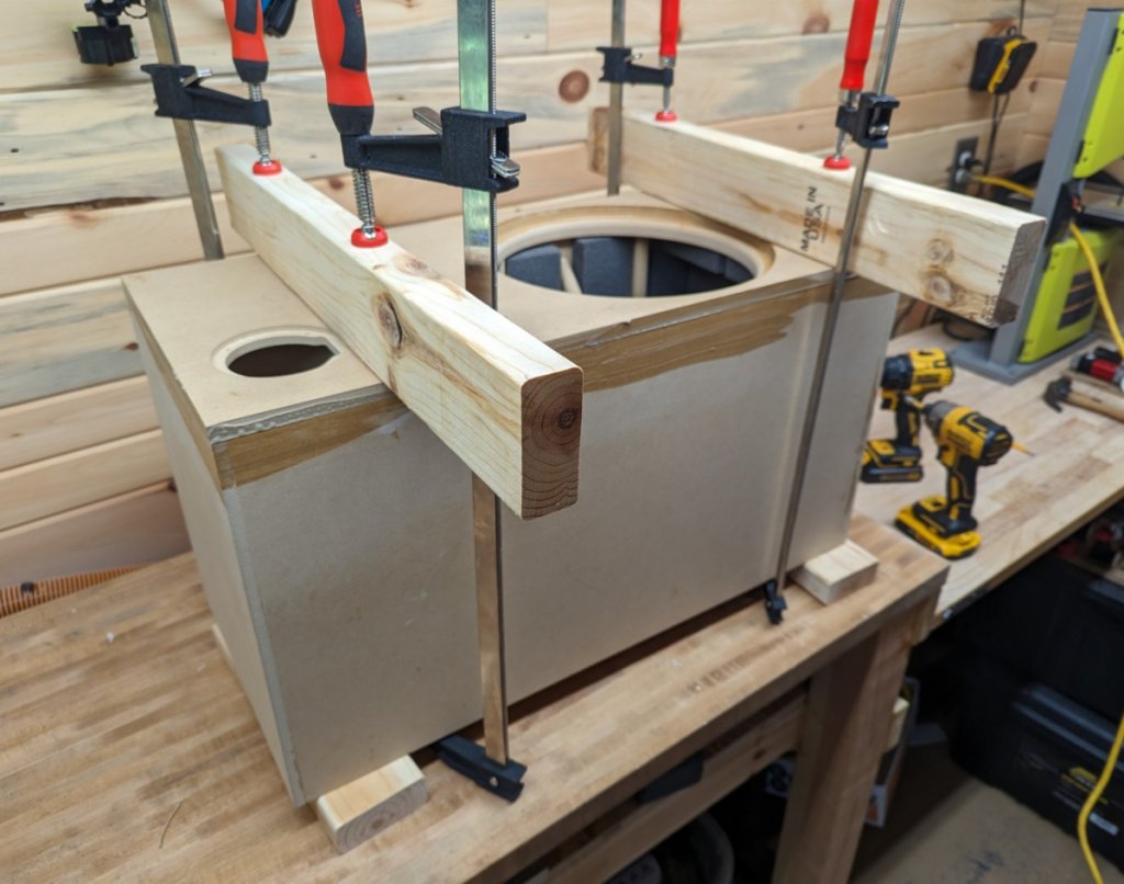

Ok, the front baffles are on and the glue has dried.
Food for thought on the glue topic. I had seen other speaker builds with many suggesting the use of titebond III glue, and that is what I used for the basic cabinet glue up. But I found that it set up quicker than I would have liked, leaving me little time to make adjustments if I had a panel out of plumb.
For the front baffles I had some Locktite PL 3x in the shop left over from a different project so I figured I would give it a go. I found it to fill some minor gaps I had in the front baffle better than the titebond glue and it provided longer fit up time to get everything perfect for clamping. In the future I would recommend others give PL 3x glue a try.
One note on using PL 3x, it does expand as it cures, so make sure you have it clamped up good before you walk away.

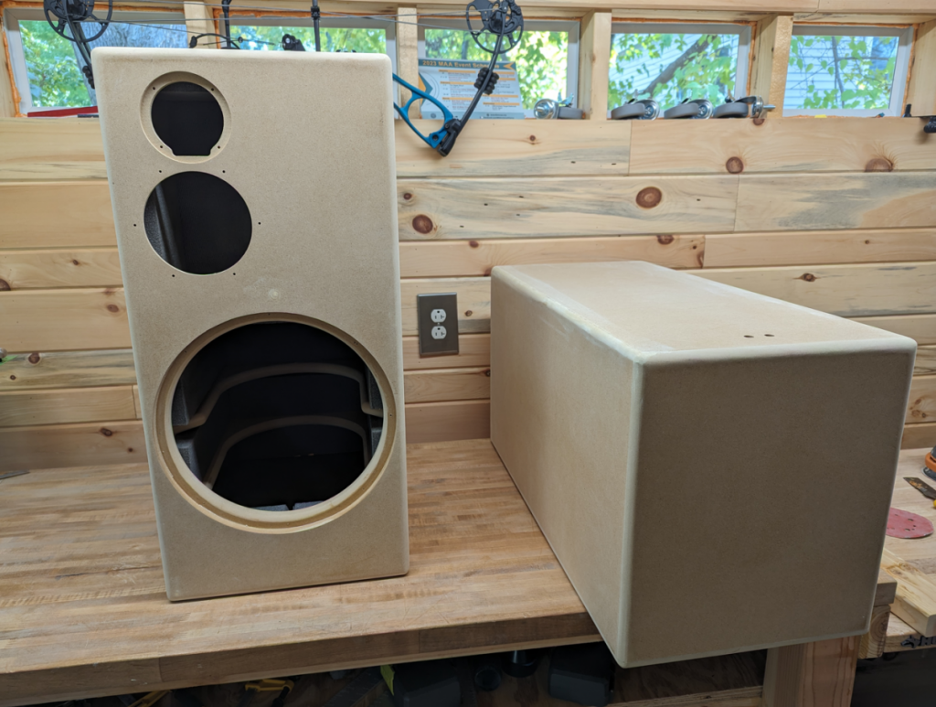

Next was getting all the edges cleaned up and ready for the router.
It was a beautiful fall day for sanding outdoors here in Minnesota  8)
« Last Edit: 21 Oct 2023, 03:59 am by Presb4 »

Then it was off to the router table.
I first tried a 3/8" quarter round bit, but settled on a 1/2" quarter round bit in the end.
I decided to use the router on all sides. These speakers are not lite, and I imagined that if I left any right angle edges on these cabinets that they would get dinged up quickly when moved. As you can see the 1/2" bit cut right up to the edge of the 12" woofer cut out.

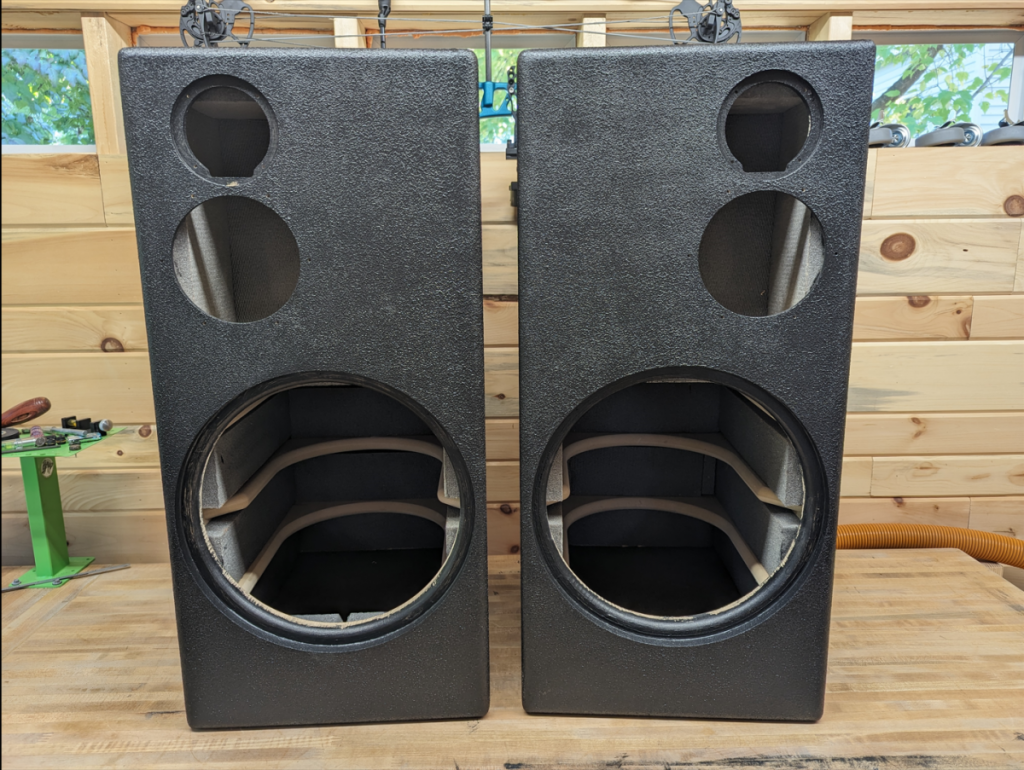

Ok, all ready for the Duratex painting.

Presb4
  • Posts: 159
Re: GR Research Brute Speakers
« Reply #39 on: 23 Oct 2023, 10:30 pm »
2 coats of duratex later and it was all done. I had to paint everything but the back side first and then flip them over after front and sides were painted and dry, then I painted the back. I had some painters pyramids and tried using them but these Brutes are to heavy to flip without getting paint all over you and the work bench. Ask me how i know  :duh:
