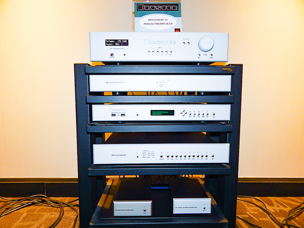

I'm as attracted to the next shiny new thing as much as anyone. The Bryston BDA-3 fell off my radar years ago, this can be a problem for mature products that have achieved technical excellence and don't need constant upgrades. Bryston products still get great reviews in the consumer press, both in magazines and on the web. The BDA-3, not so much anymore. I don't mean it doesn't get great reviews, it just doesn't get mentioned at all. The most recent mention was as part of an all Bryston system at the 2023 Montreal Audio Fest.
https://www.stereophile.com/content/bryston
The BDA-3 was reviewed in the Stereophile November 2016 issue by Larry Greenhill, who wrote "I recommend that the BDA-3 be listed in Class A+ of Stereophile's "Recommended Components."
https://www.stereophile.com/content/bryston-bda-3-da-processor
The BDA-3 achieved an A+ listing in Stereophile Recommended Components in 2017, 2018, and 2019. Stereophile has a policy that if a product isn't reviewed in 3 years then it is removed from the Recommended Components listing. An unfortunate circumstance for products that don't need to be upgraded every 3 years. As technologies mature Stereophile may have to extend how long a product is listed.
There are always new DACs appearing so not many reviewers are going to review a 7 year old DAC, let alone say it still sounds better than the latest and greatest.
