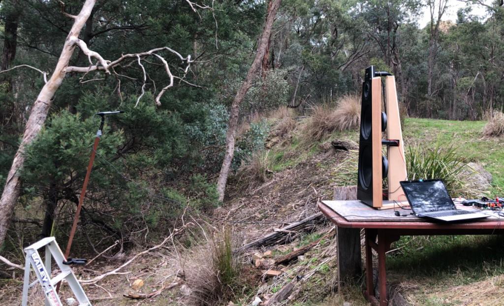

Listening tests inside but directivity/FR tests outside on a rig largely free of reflections in the mid-treble range. I rotate the speaker and keep the mic on the ladder... look closely!!

I do a full range of tests in my listening room but apart from distortion measurement they need to be near field to get results that aren't effected by the room. I've tried windowed impulse response for FR but when I'm tuning crossovers I prefer a continuous measurement.
Outdoor measurements are good for seeing the behaviour of a specific driver in a specific baffle geometry.
IMO I think outdoor measurements are useless unless it sounds good in your room, but outdoor tuning should ensure it sounds good in most rooms.

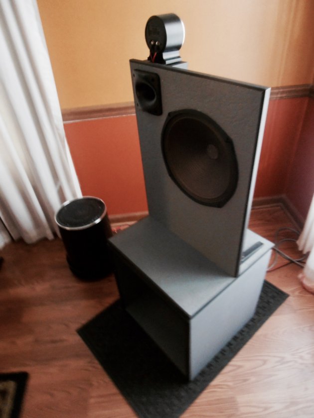

I just got one of these rotating platforms and it is much easier to do off axis measurements now.
https://www.arborsci.com/products/rotating-platform
