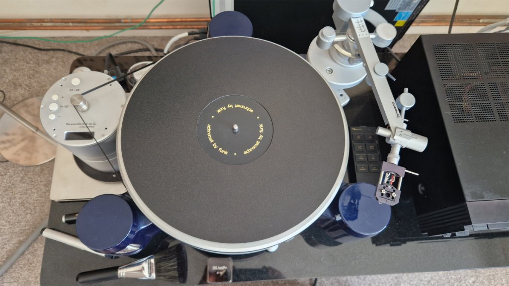

I use the Achromat APM, which is Achromat and glass bonded together. Like nlitworld said I would not go back to any other matt.
Since using the Achromat APM, I get quieter background noise and many other benefits. One bonus benefit is, I no longer have static problems.
If you are going to go for the Achromat, make sure you can adjust your VTA on your tonearm. Achromat APM is 7mm thick.
