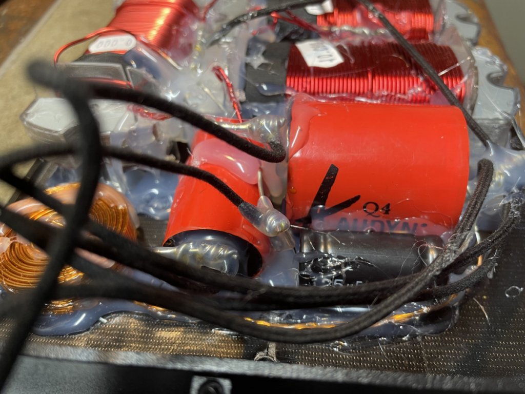

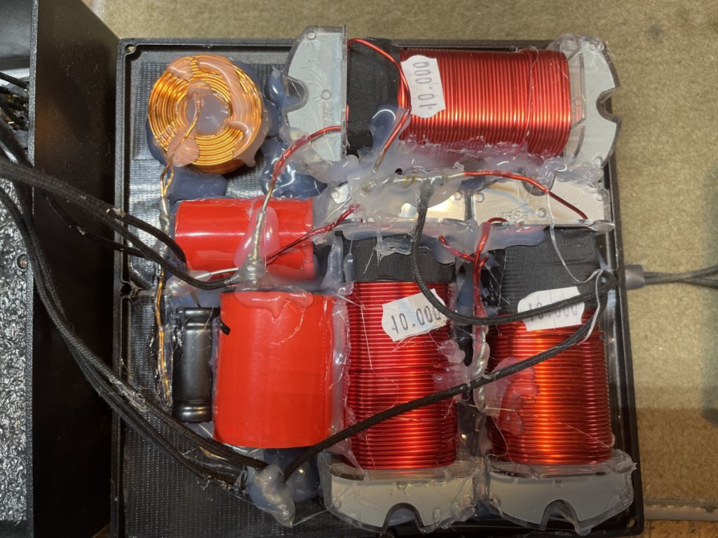

« Reply #34 on: 11 Sep 2023, 05:34 pm »
Mr Big, I have always wanted to know what is in the crossover of my M3's but haven't brought myself to open it up to see. Apparently you have. My understanding is there are two inductors and one cap? What did you see when you went inside? (type/manufacturer/mounting/etc.).  Pictures if you have them would be awesome.
Well I had laid my M3 Sapphires down to do some work on my IsoAcoustics feet. I decided to satisfy my curiosity and look inside the crossover. I was surprised to find there were more components than I thought there would be (Spatial touted the "minimal" crossover on the M3 Sapphire). The components are of "good" quality. There are cored inductors manufactured by Erse who claim they rival air core? So not what I was expecting but I am not compelled to "upgrade" anything.

Jaytor
Re: Support for a great brand
« Reply #37 on: 11 Sep 2023, 09:11 pm »
This crossover actually is very simple. I suspect the three ferrite core inductors are in series to create an effective 30mH. So you can think of these as a single component. I'm assuming that these are on the woofer circuit. Changing these to air-core inductors might be a small improvement, but they would be WAY bigger. Jantzen makes 14ga 15mH air-core inductors which 91mm (~3.5in) in diameter and 62mm (~2.5in) tall. Foil inductors would be even better, but even larger. 10mH 14ga are 149mm x 37mm and you'd need three for each crossover.
The one part that I would be most interested in replacing is the electrolytic cap in the lower left. But again, a replacement film cap is likely to be much larger which would probably necessitate an external crossover. And it looks like this cap is already bypassed with a film cap which provides some of the benefit.
Changing the two film caps could also change the sound to your liking, but the differences will be more subtle and could certainly result in a sonic signature that you don't like.
If you are interested in upgrading your crossover, I'd suggest talking to Clayton. He is well aware of the value of quality crossover parts and might be willing to provide some guidance. But it's likely to cost you upwards of $1000 or more for the pair to get an appreciable improvement.
If it were me and I wanted to pursue this, I'd build a completely new set of crossovers in a separate external box so that I could switch back to the stock units to compare after the new crossovers were well broken in. Many of the more exotic film caps take hundreds of hours before they sound their best.

« Reply #38 on: 11 Sep 2023, 11:28 pm »
Two of the Caps are Audyn.
