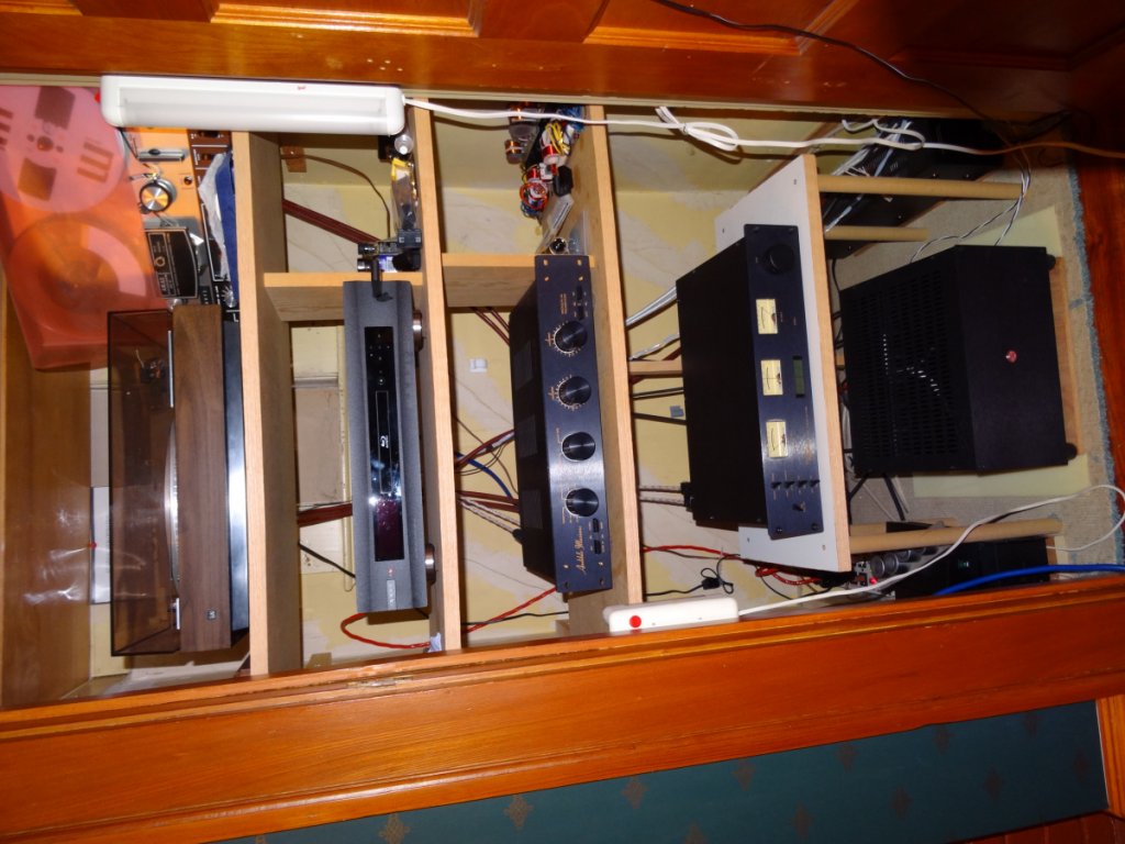

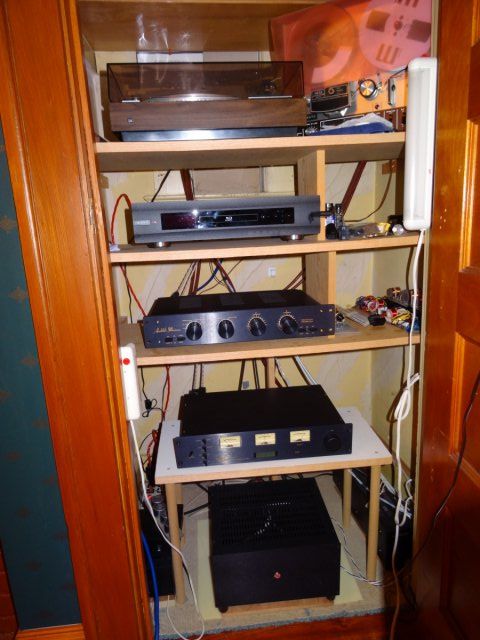

One of the reasons my Dual 1249 sounds so good, to me, is that it is located in a closet.
The Closet is almost dust free. haven't had to wipe the dust cover in a couple of years. And the boards, the components rest on, rest on wall mounted 1" x 1" pieces of wood that are the full length of the depth of the closet. This makes getting to the back of components a little easier because the boards easily slide. That is one can be pushed all the way in and another can be pulled out a bit. I also have a 12" x 3" mirror that hangs on the back wall. I spent a 1/2 hour trying to get the pic vertical but gave up.

Thanks for fixing the photo.

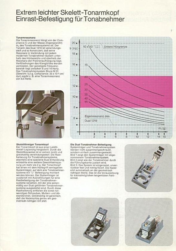

What would be a good, new, $300 max, MC cart for the Dual 1249.
The Dual 1249 has a low mass tonearm, a MC cartridge will have to be carefully matched. Info on this arm is hard to find. My old Dual 1009F has an ADC VLM cartridge that has long been discontinued. I can't comment on the sound because all the electronics and speakers I owned at that time were low fi. I use the 1009F to play 78 rpm records.
AudioKarma has a thread about the Dual 1200 series tonearms:
Mass of a Dual 1200 series tonearm?
https://audiokarma.org/forums/index.php?threads/mass-of-a-dual-1200-series-tonearm.439674/
"I've tried the [Dynavector] 10X5 ($800) on a 1219 and it sounded fine. It doesn't sound better than any number of other cartridges, though, IMHO. The 1219 - for whatever reason - just doesn't allow the 10x5 to show how good it is. On my Scout, the 10x5 shows a remarkable soundstage and detail with a clarity that is excellent. On the 1219 a large part of that is lost. I really wish that I knew why."
Dual 1219 tonearm with Shure M 91
