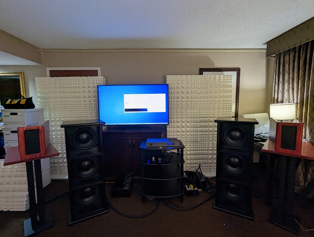

Theronbo
Hi Guys,
    I have two dual Servos ( both pointing forward) with the Duratek coating on them in black and am moving them into my main rig to complement my Spatial X-3's which are in a Matte White finish.  The subs are currently looking very DIY....they are from the standard flatpack from Jay.
 Goal of this project is to :
1.  change the finish to white or perhaps a different color but not the Duratek black as that has very low WAF.
2.  Improve the aesthetics of the subs as much as possible.
3.  Also I need to make grills for them as well.
Question:
1.What is the best method to get my speakers matte white?
--Sand and repaint?
--sand and wrap with a matte white wrap?
----how easy is it to sand the Duratek?
My 2 cents.
Simplest approach: Buy a dozen cans of Rustoleum American Accents Stone spray paint
Spray directly over the Duratek.
Stuff has a texture also… result on top of Duratek might be interesting.
Otherwise… buy new flatpack… veneer.

DonS
  • Posts: 10
I found turning the lights off works best..
Whereabouts in Arizona are you?
BrandonB
  • Posts: 529
That's funny.  They grow on you the more you look at them
