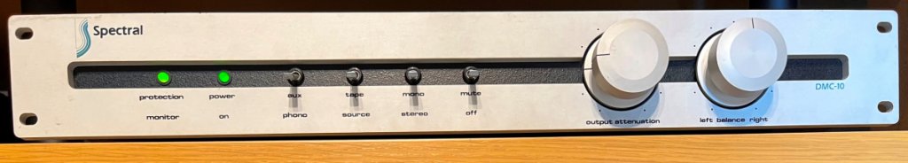

Figure 1. Spectral model DMC-10 Preamplifier - photo taken after repairs completed.

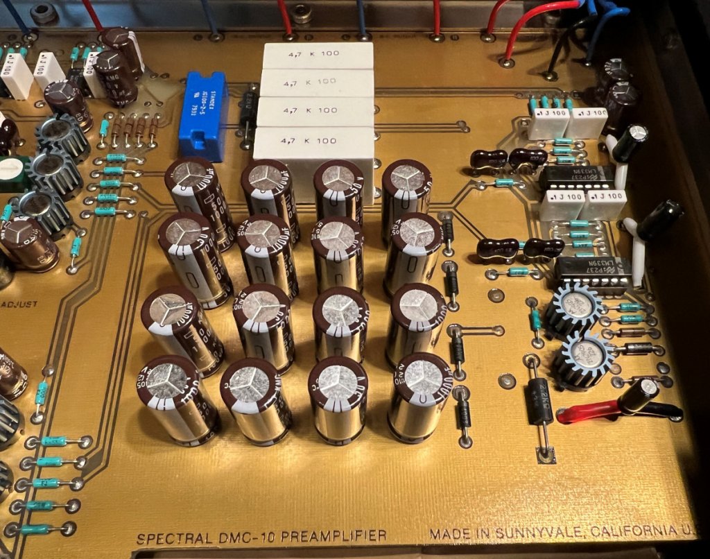

* In 2022 I brought my preamplifier out of storage and powered it up for the first time in 20 years.  Although it was basically working and usable, there was something wrong with it.
Failure Issue
* Initially I noticed an increase in hum noise, later followed by the protection monitor LED illuminating Red.  At this stage the preamplifier's power supply had become hot and the unit inoperative.
* The heavy current load on the power supply was finally traced to two of the bypass capacitors leaking.  Although the leaking capacitor's electrolyte had spilled onto the printed circuit board, fortunately the damage was mostly on surface, and I was able to fully clean the affected area.
* As a precaution considering the age of this unit, I felt it best to replace all electrolytic capacitors with new.

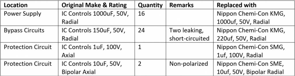

Summary of Electrolytic Capacitors replacement
Table 1. Capacitor replacement summary.

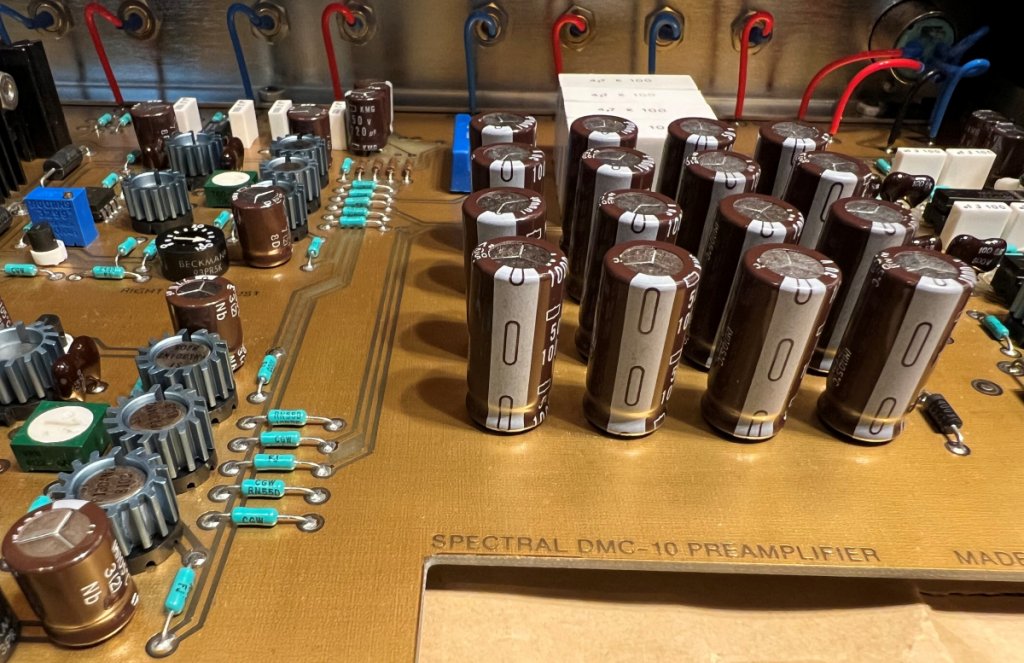

Internal view of replaced components
Figure 2. New bypass capacitors (left side), new power supply capacitors (right side).
Figure 3. New power supply capacitors (center), protection circuit axial capacitors replaced by radials (right side).

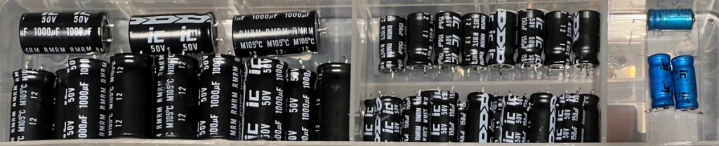

Parts replaced
Figure 4. Original components replaced.
* Left bin: Power Supply capacitors qty 16.
* Center bin: Bypass capacitors qty 24 (two of these were leaking).
* Right bin: Protection circuit; Bipolar axial capacitors qty 2, axial capacitor qty 1.
