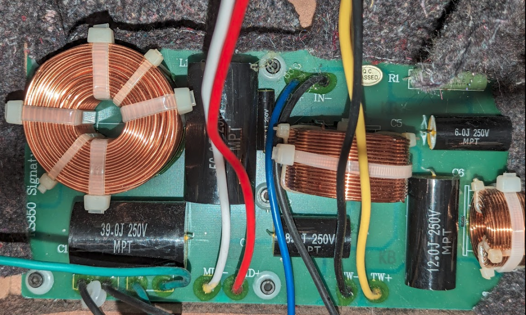

They are the Signature Edition but not sure if that meant an upgraded crossover or not.  I'm going and try and get them hooked up this weekend but will probably pull a driver or 2 and look inside to see the crossover.
Thanks for all the information so far!

That one was one of the originals that measured really poorly. I then redesigned them and my crossover design was put into later production models.
I can provide all of the parts you'll need to point to point wire a new crossover that will transform them into a pretty good sounding speaker.
Just call or email us.

After doing some fairly critical listening to these it certainly appears that there is a significant lack of bass.  Perhaps failed crossover components?  Danny - could you send me a list of components required to upgrade the crossover?
Danny Richie
Re: AV123 - Onix Rocket RS850
« Reply #8 on: 30 Jan 2024, 10:44 pm »
The later versions of this model had a completely new crossover that I designed. It was MUCH better than the original.
So the first thing to do is see which crossover yours has.
Email me a picture of it.

Tyson - great idea.  It worked.
I pulled the loose ferrule (?) out from between the black wires.
Danny Richie
« Reply #12 on: 3 Feb 2024, 11:12 pm »
That is the one that I designed. It produces a smooth response.
I would just upgrade the caps in the tweeter circuit to some Sonicaps, replace the wiring, and replace the binding posts with tube connectors.
