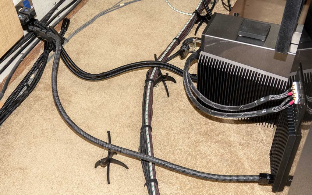

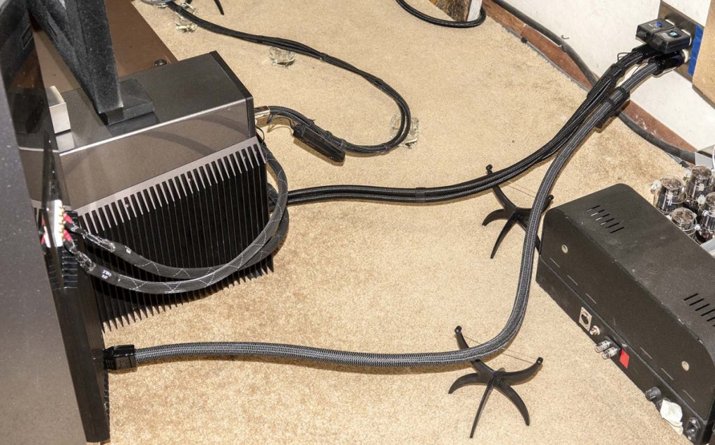

Here's an amp.  FWIW, mine run quite hot.

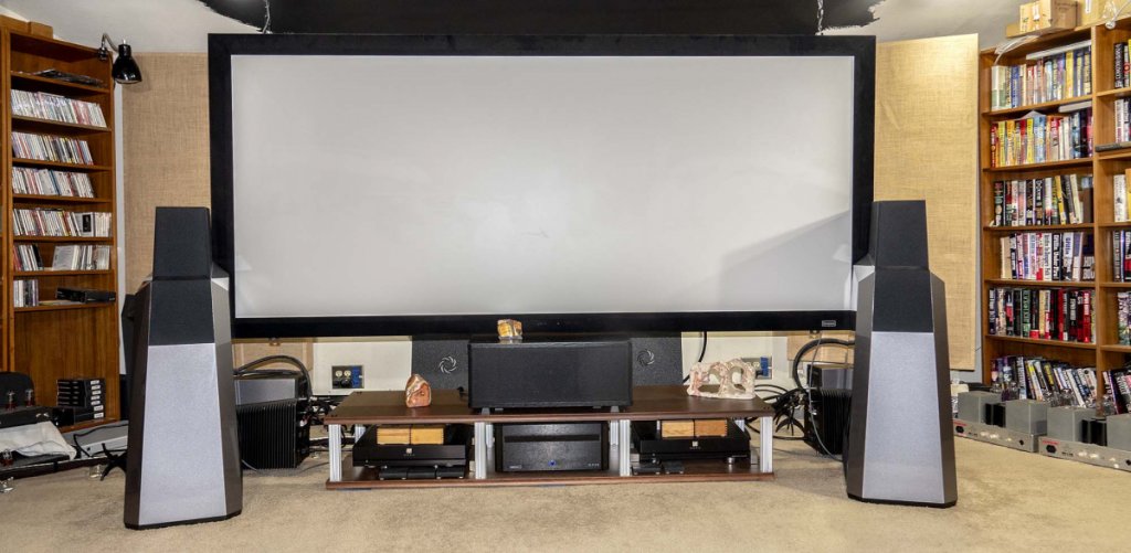

In the top pic, the screen is 'down' in movie-watching position; I usually chain its bottom to the front wall for music listening.  The system is the most resolving I've ever heard.  My fellowaudiofool goodbuddy and I got the bassamp adjusted, but altho the speakers are measured to be the same (= within 1/4") distance from my nose, the speakers are pointed only generally; I plan to ask our former VS dealer if they still have the measuring equipment and will come to adjust them properly.

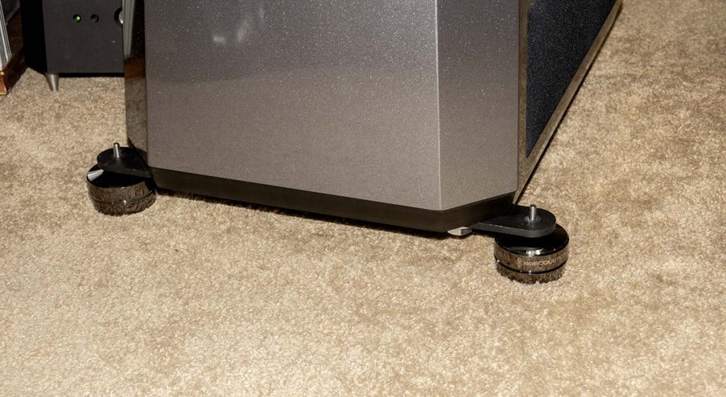

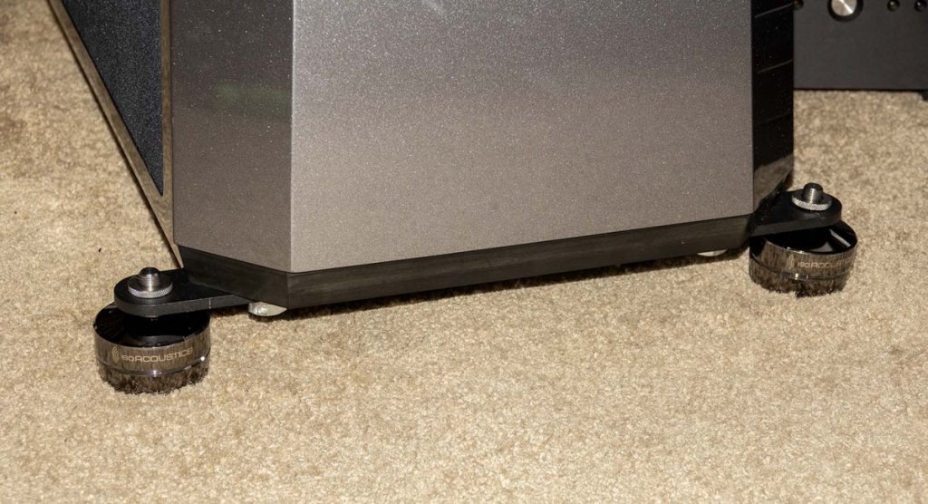

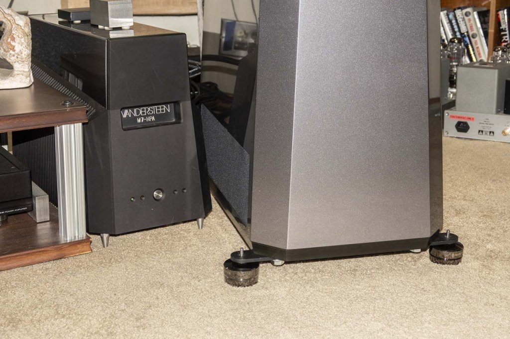

...which is somewhat of a project with the 7.2s' 9/16-18 spike threads.  Already had these spike bars...
...which I easily attached with 1"-long* capscrews (and double flatwashers) screwed into the original spike holes in the bottom of the bottom plate.  The bars have 1/4-NC threads for the spikes, and the Gaias come with that size stud adapters, but the quarter-inch screw looks quite puny for the weight of the speaker.  I'll be drilling and tapping the holes to 12M-1.25 to use the full-diameter (= no stepdown of diameter) stud supplied with the G-Is.  The rear will require a special 9/16"-diameter stud with M12-1.25 male threads on its bottom to screw the Gaias onto; that's in process.

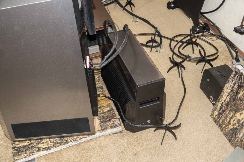

Moved the poweramps, too.
* that is the maximum length that will enter the two blind holes at the front of the bottom plate.

Got the spikebars drilled and tapped to the 12mm threads that are native to the Gaia-Is; they look MUCH better to me, and I know they're stonger.
Also received the smaller spikebars (for the rear) from AudioExpress and will have them done in a week or so.
Received the AQ Dragon PCs for the M7s and Blizzard Extreme PCs for the bassamps; wiring looks MUCH better now and is easier to keep isolated.  Am plugging these PCs into the wall outlets fed by my two 20A. dedicated lines.
