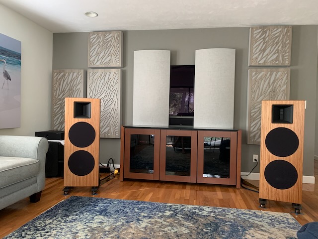

Yes. I had absorption first and felt the sound was a little dead. I much prefer diffusion. The 86” tv is flat against the wall which helps. It’s not perfect but but I’m really happy with the sound overall.

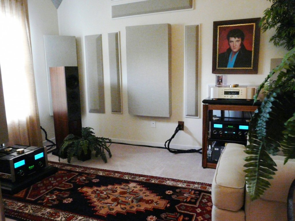

1st reflection point on each side wall is needed, and 2 panels more on your front wall. 24 x 48 2" thick absorbers with diffraction built-in beside each window, GIK sells them, and you have the best of both worlds. and get some heavy curtains for the windows that will most certainly help imaging in the center, I use ASC 8" x 48" 3 of them behind my blinds, right, dead center, and left, you don't see them with the curtains. A few pictures from my old system with Quads and bamboo curtains and the 3 panels and one current with my Spatial M3 Shappries and curtains the panels are set on the window seal behind my blinds and I have the blinds tilted somewhat upward and they work then as diffraction. I tried them facing down and imaging and tone were negatively impacted believe it or not. I had more panels and the 1st reflection points at one time but the room looked good but like a studio with nothing but panels, so I decided to make the room look more warm and inviting so I had large canvas panels made for me. These were one of a kind like the Beatles alt. Cover for Sgt. Pepper and the Elvis and on the other side wall is another large 48x60" canvas print and another 8"x48" ASC panels so to match the wall you see in the picture is all the same on the left wall that you do not see. So both sides are identical thus perfectly balanced sound from both speakers. 3 pictures in the same room over the years, the last one was perhaps the best sonics but I wanted a more inviting look so the Cavans prints started.
My room has no back wall due to it being an open loft to the family room below. So the wall the speaker sees is 30 or more feet away.
« Last Edit: 1 Jul 2023, 03:40 pm by Mr. Big »

RPG BAD Arc panels in front
https://www.rpgacoustic.com/product/bad-arc/
I also cover the TV.

Of course every room is different, so who knows. Here is what I used prior. I don't think the pretty face panels do much for this other brand acoustically. They also absorb, but I removed them and put much bigger and thicker traps in the rear of the room. I originally bought the BAD Arcs to cover the TV as they're light and easy to move in and out of place, but I liked them better directly behind the speakers when I changed to the SRA Scuttle rack.

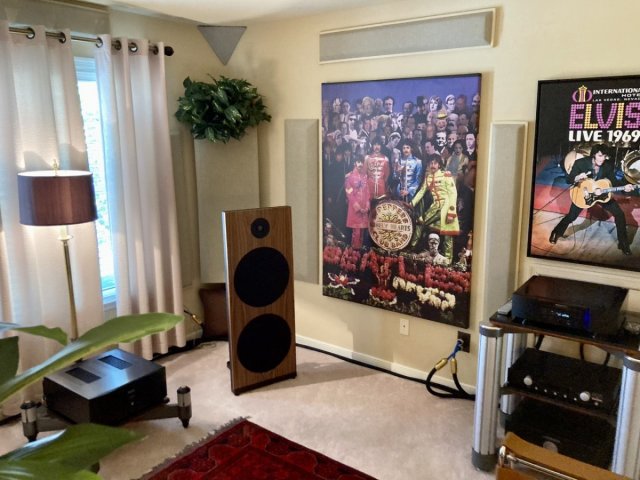

Hiding the treatments behind curtains is brilliant.  The wife will appreciate it.  If effective in my space I also appreciate the narrower ASC option.

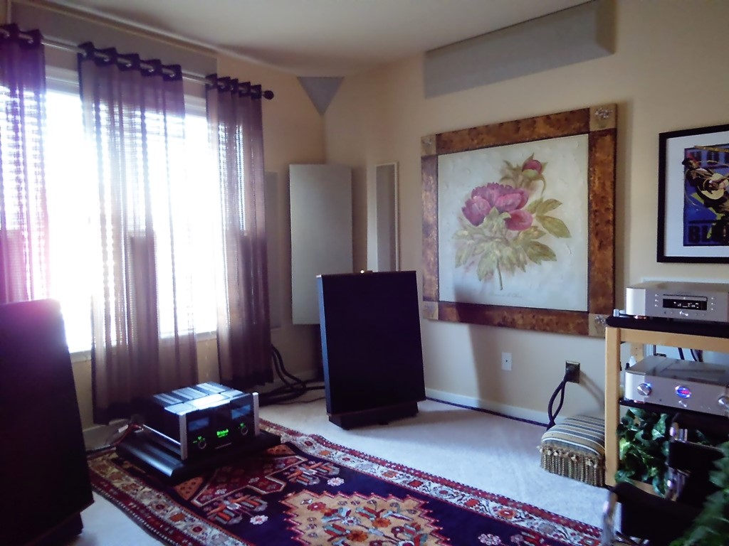

I should have used a wider view image. The space is asymmetric.  RH wall has GIK panels.  I also have similar freestanding panels but don't recall if I've ever concentrated on the sound stage with them in place either side of the rack.

I agree that curved (constant-radius) diffusor might be the best solution, as you're not interrupting the transient's important to sound imaging. I just bought a couple of different room treatment options. ASC tubes and Acoustic Geometry panels for the first reflection. Of course I didn't bother to match any of the colors :) I haven't fired the system up yet. So yeah diffusion behind the speakers might be the best solution.

Thank you. I only have the curved panel next to the GIK for comparison. I'm on this kick of not running my air this year for whatever reason that I haven't been listening in a couple weeks. Been 80ish in the house :)
Well I decided to turn my air on at least so I can try these panels out this evening.
« Last Edit: 2 Jul 2023, 10:04 pm by DaveWin88 »

OK guys / AllanS. I'm going to start with the crazy talk first, then explain what I'm hearing.  As far as the Acoustic Geometry curved diffusors go,  there's no option. You have to have these for your first reflections. When I first started to listen to music tonight, I was immediately shocked at how different it sounded. It's probably the real first time hearing the Spatials on their own if you will. The tone was noticeably better? consistent for absolute. I was playing vinyl for the first hour or two, then switched to Cd's. Side note, the Jc5 and even the A21+ sounds quite a bit better after listening for two - three hours. One of the biggest things is that the panels completely disappear, and they take some of the wall with it. I know that sounds weird but what you normally hear from the extreme sides of your head just flat out mostly gone. John Calder from the manufacturers video was not lying about imaging. For the first time I've had the A21-JC my image is tighter, more focused, and very very well grounded. Before it was always vague and floaty if you will.   I'm hearing detail like I've never heard mostly because you're not getting the delayed sound and more importantly the tonal differences that come along. These will give you an honest look of what your system actually sounds like. Guys this is not subtle. It's almost like the first time hearing your Spatials and being floored at how much less they interact with the room. These ADD to the same effect. Full disclosure. I do have my speakers closer together 6 foot apart to be exact. But I've had these for a year and a half and I know very well what they sound like in this room. So the soundstage did get narrower (focused) but if you close your eye's it seems very appropriate. You definitely get a better sense of the venue, and venue boundaries. Tomorrow after work, I'm spreading my speakers further to widen the soundstage a tad. A video from The Absolute Sound that they did a couple weeks ago,  Robert Harley stated that if there was only one thing you did to your room this should be it. Man he was so spot on, and maybe even understated. What it did for the image, detail (by getting your room out of the way, and the tone of the presentation) the panel completely I mean completely disappear. It's staggering. You know we buy new cables and such to try and improve the soundstage and detail,  and it never seems to get you there. This is like buying a component for you rig that actually achieves it. I'm so impressed that I'm contacting the company and complimenting them on such a wonderful product. This is major. I do still have bass issues, but I'm determined to get it figured out. btw the fabric I chose looks like it's right out of the 60's :) us old guys can appreciate that. This also fixed the fact that my room is less than ideals like most of us. What a great product.
Guys this is a very big improvement.
