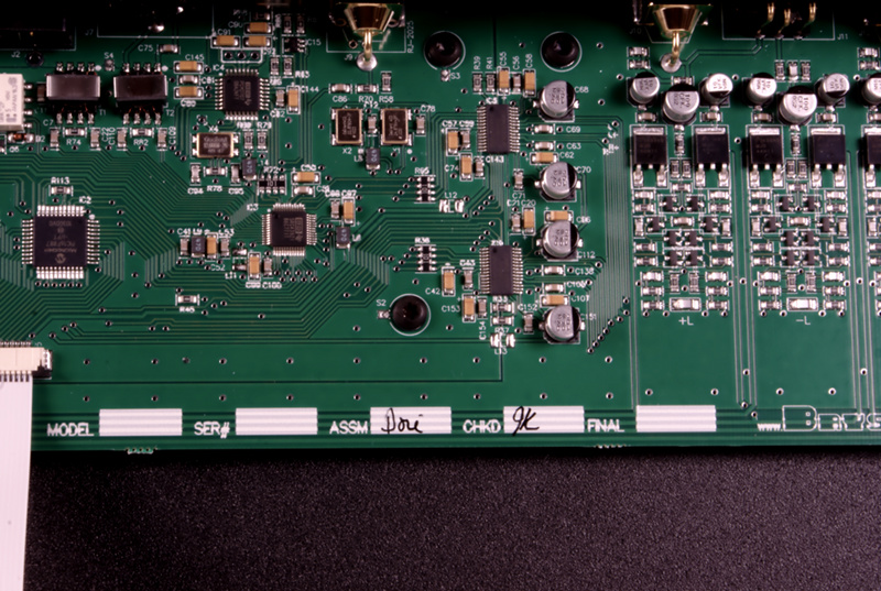

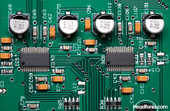

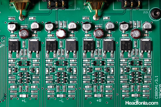

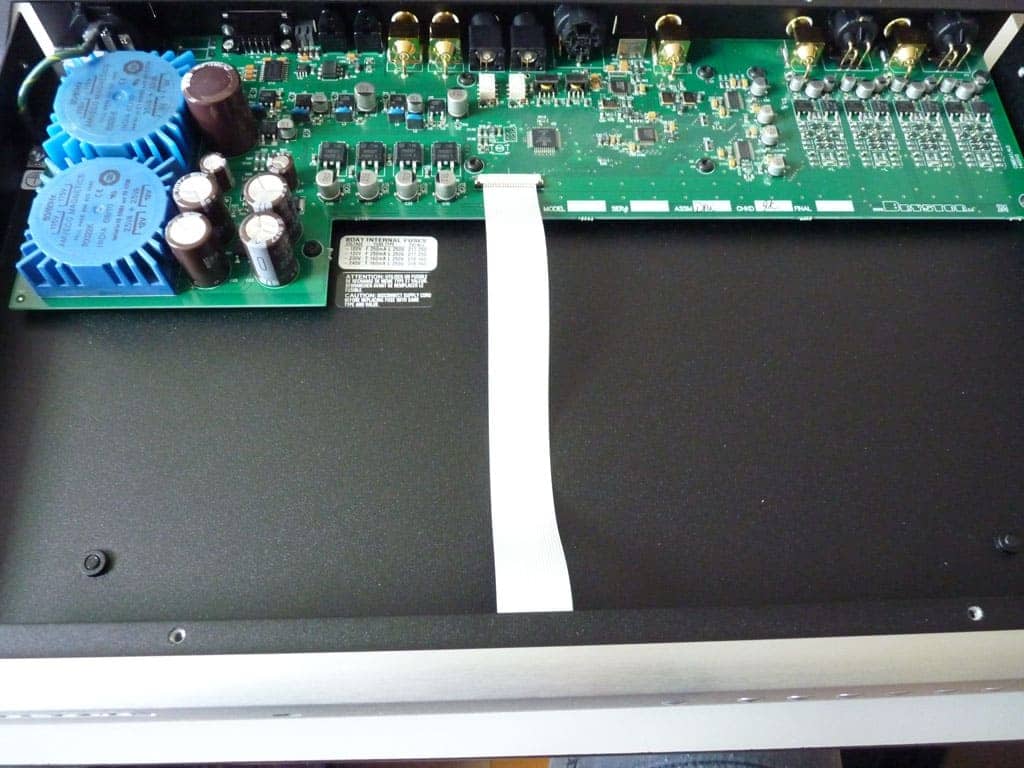

« Reply #8 on: 30 May 2023, 06:44 pm »
FYI, the modification project my client is considering is to dual-parallel the CS-4398. What I noted earlier. This is what Arcam did in their FMJ CD33 cd player from 2004 with another, similar delta-sigma DAC chip (WM8740). Arcam used four of them; two parallel (stacked) and then each of those stacked pair in mono mode. So, two stereo DAC chips for R; and two  stereo DAC chips for L.
Arcam also obfuscates much of their topology  by unobtanium service manuals and schematics. Which is the exact opposite situation of major players like Philips and Sony.
See:
https://www.hifiengine.com/manual_library/bryston/bda-1.shtml
Below are photos found in Google images searches of the BDA-1 PCB. Tracing the handiwork should be .... ahem .. fun!
« Last Edit: 30 May 2023, 08:04 pm by 13mh13 »

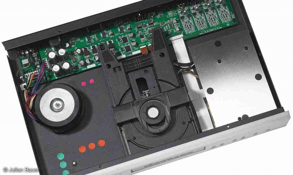

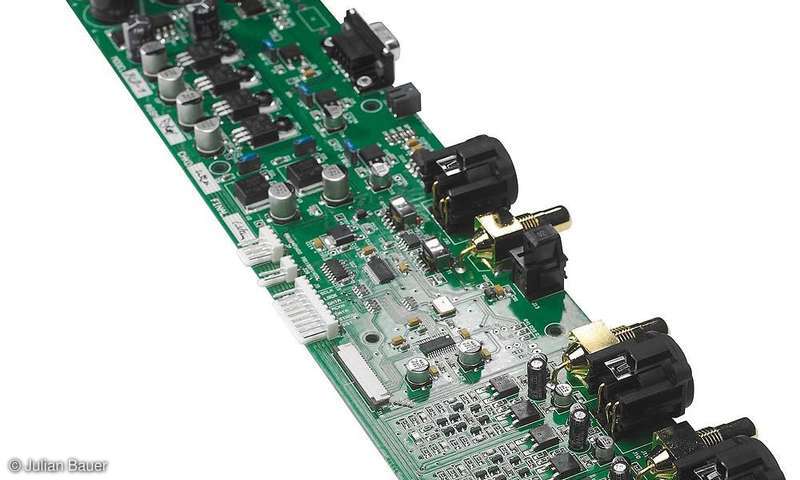

13mh13
Re: Question about BDA-1 dac
« Reply #9 on: 31 May 2023, 10:08 pm »
I did find some PCB shots of the similar BCD-1 cd player (2008) that uses no SRC and a single CS4398. Notice the similarity of the output stage. BOTH the dac and the cdp feature balanced (din) and std. (rca) outs.
