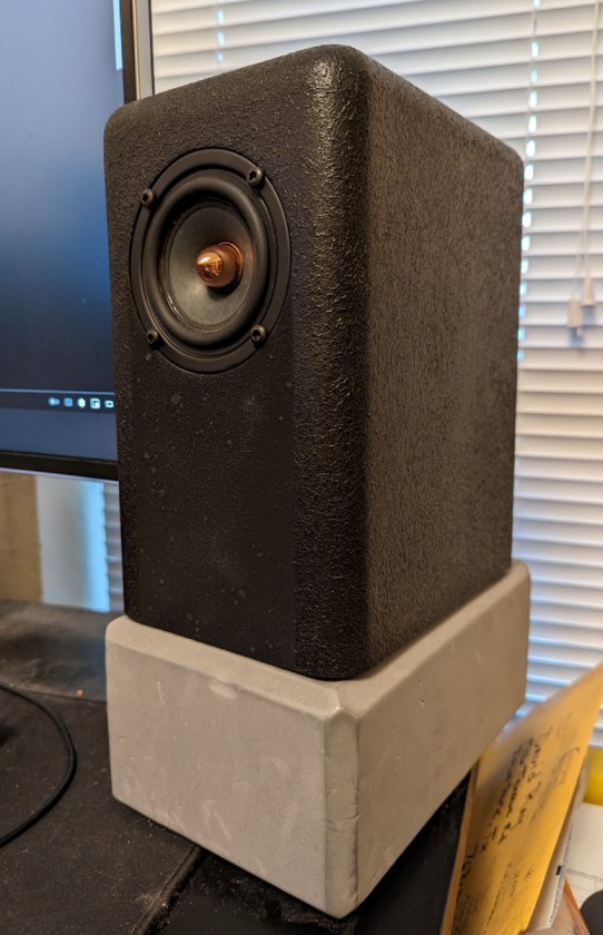

DuraTex applied.  Black is cool but we're going to paint over it shortly:

For us, black is fine as a base layer coat (ie, a primer), we'll probably do a high gloss finishing paint on top of it.  I really like how high gloss looks over the textured DuraTex.
