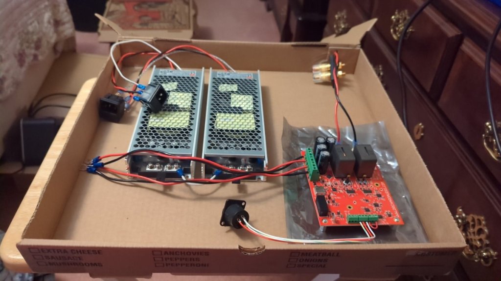

Wanted to try out the Orchard Audio Starkrimson Ultra Class D amp modules and decided to purchase a pair of DIY modules from Leo.
Decided to try out a different SMPS DC power supply, so purchased a pair of Mean Well SMPS for 36VDC @13.8A PFC version units to stack for the +/-36VDC power supply requirement.  This version SMPS has an aluminum case for cooling and shielding.  Yes, this does mean the total SMPS is capable of 1000W power to the amp modules.  This will probably need a soft start circuit added eventually.
I am terrible at making chassis for projects, so picked up some 16in pizza boxes for the temporary housing.  Used something similar for the LM3886 Chip Amp project awhile ago, but these are better built boxes.  The SMPS are actually lighter than the toroidal transformers I used for the earlier amp linear power supply.
Testing the SMPS first to make sure stacking is not a problem with small load resistors before connection to the DIY amp modules.

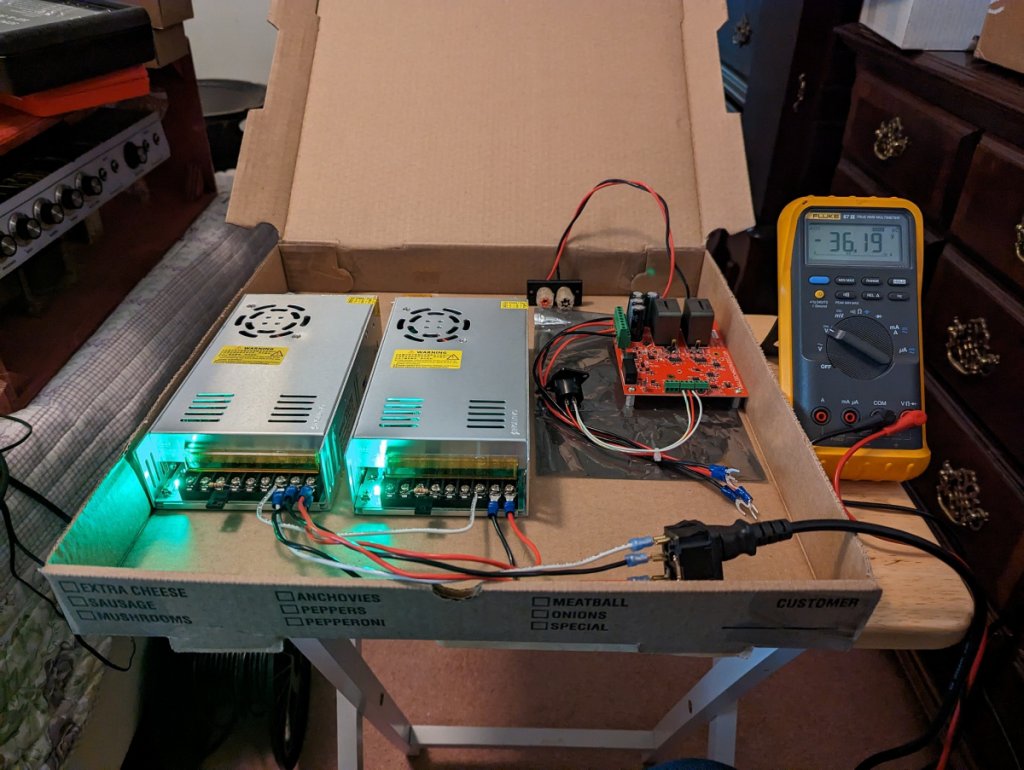

« Reply #8 on: 25 May 2023, 12:33 am »
The two SMPS for +/-36VDC at 16.7A is up and running.  These have fans so they can run both 250W amp modules simultaneously.
The wiring is 14awg for DC power, so might try remoting the two SMPS in another pizza box for EMI/RFI reduction to the amp wiring.

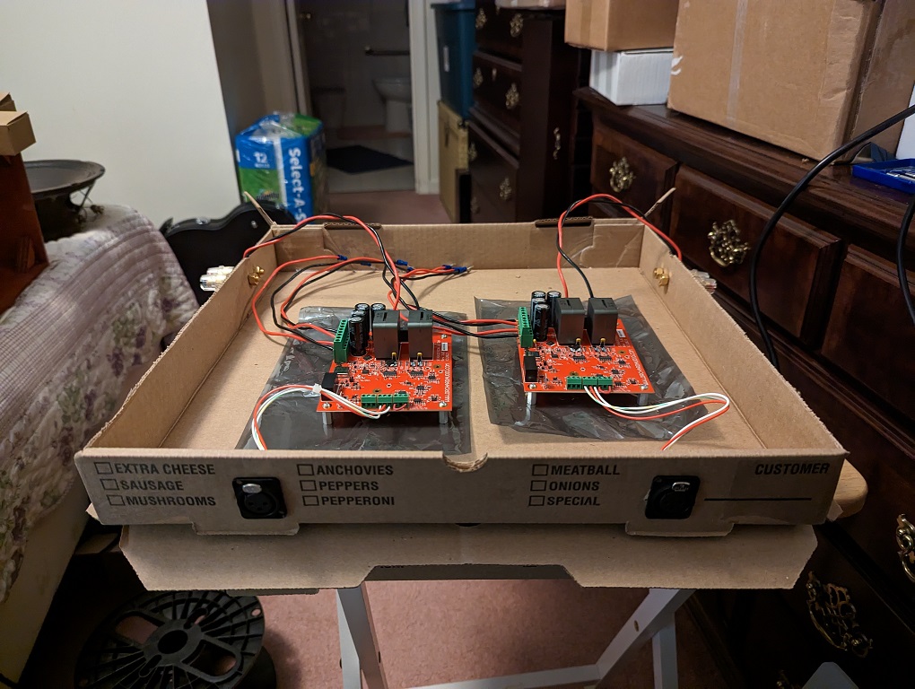

« Reply #13 on: 25 May 2023, 09:59 am »
The input and output wiring is done in the two channel pizza box.   Easy enough to go dual mono, just add one more pizza box.
Will put a seperator between the channels.
Now for connection to the SMPS to try them out.  Yes they are going in another pizza box.  :thumb:

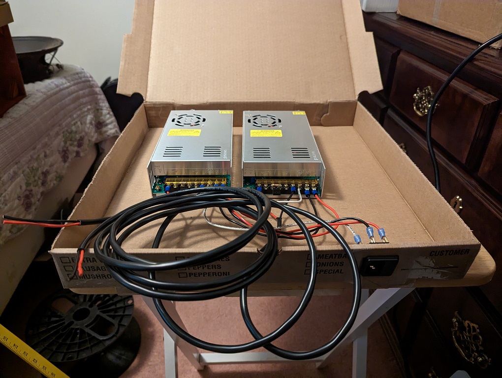

« Reply #14 on: 25 May 2023, 10:41 am »
Pizza Box Amp +/[email protected] SMPS ready for wiring to the amp modules.  Using 14awg stranded Belden 1309 cables for the DC power.
Will add a capacitor bank to the amp module pizza box to lower the impedance at the amp end and help filter any SMPS noise further.
