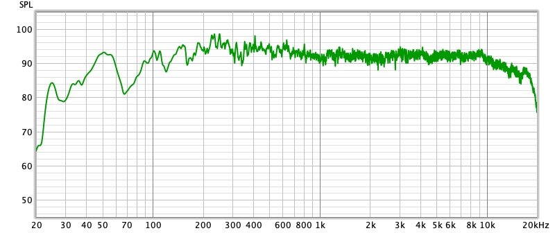

This is what it looks like now:
I am blown away by the difference... SO MUCH MORE detail... HUGE soundstage ...
But... I am pretty sure things can be improved further.
For instance, the area around 2.1/2.2 KHz... can sound aggressive (depending on the songs) ... electric guitars... and "EEEE"-vowels can be really annoying.
One thing I have noticed:
With the LS50 meta (which I also own and like) and the KEF references, the crossover from mid to tweeter is at 2.1 KHz (the KEF blade at 2.0 KHz), while the R-Series speakers cross over at 2.3 or 2.4 KHz.
I would love to come closer to the sound of the LS50 Meta (not the old LS50) and the KEF Reference speakers which offer more space and openness in the upper mids.
Measuring doesn't show a peak around the annoying area... but it's there and some albums are not fun to listen to any more...
45 cm distance, on-axis
ANY suggestions are welcome!
- Marko
