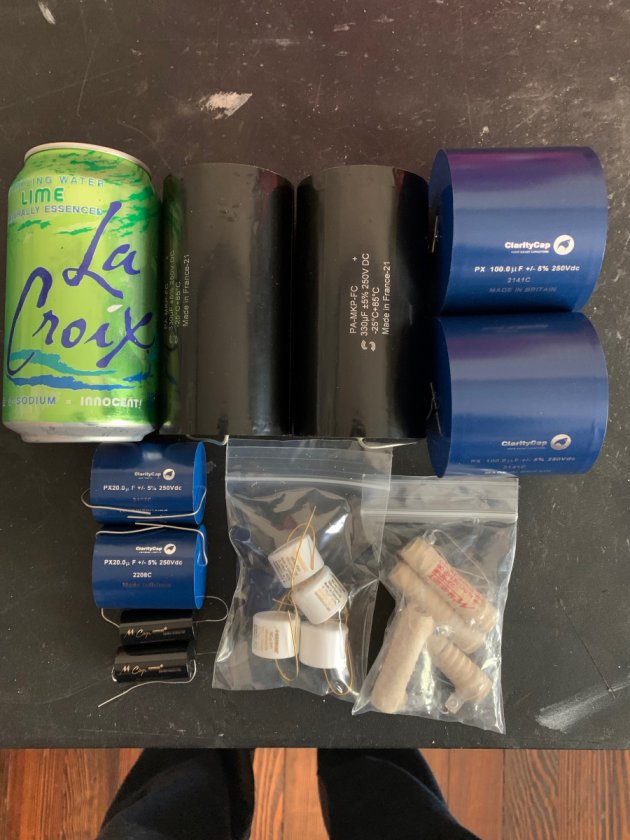

Then with the 330uF, the best option will be to bypass it with a 1uF polycap. As 330uF is a massive value to try to replace with all polycaps unless you bundle three110 caps in parallel hanging off the board.
Solen does make a 330uf cap, and it is the size of a 12 ounce soda can. You could replace it with a Mundorf electrolytic or similar and make gains, as well as bypass it like Hobbs recommended. I rebuilt the xovers in a pair of electrostats that had a 330uf electrolytic like yours. I got the Solens from Parts Connexion with the rest of my bits and pieces, but you could find them elsewhere I'm sure. It looks like at least one of the sandcast resistors is still on the board, replace it as well, you will not be disappointed.
Good luck,
JCarney

My only concern with a giant 330uF polycap, or a bundle of large caps is size constraints of the cabinet
The modern Kef speakers are very well brace, leaving very little room for such large polycaps.
I thought I would post the pic so Marko, and anyone else curious could see it does indeed take up some real estate. I had to go outboard due to the size of the poly caps I choose. Would a Mundorf, or other more audio related electrolytic be a good idea? I did suggest that, but do not want to mis-inform him. You are always very helpful and friendly Hobbs, I want to Thank You for that.

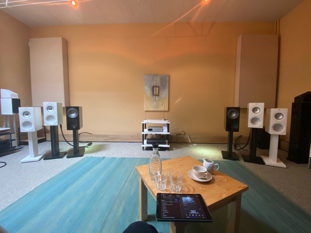

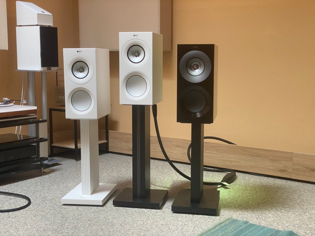

Today I was able to compare my modified R3 to the new R3 Meta and the Reference 1:
Although the new META version of the R3 does sound more balanced and open than the older R3... my modified R3 does reveal A LOT more detail and soundstage. Even more details than the Reference 1...
And - compared to R3 Meta my annoying high frequencies are actually even smoother... so I guess I can live with that after some more burn-in-time.
but...
the Reference 1 is an outstandig balanced speaker, easy to listen to... no fatigue... and yet lots of detail.
Plus - the bass with the Reference 1 is tighter, and way more precise.
I wonder if there is something I can do to my modified R3 for a tighter and more precise bass performance.
