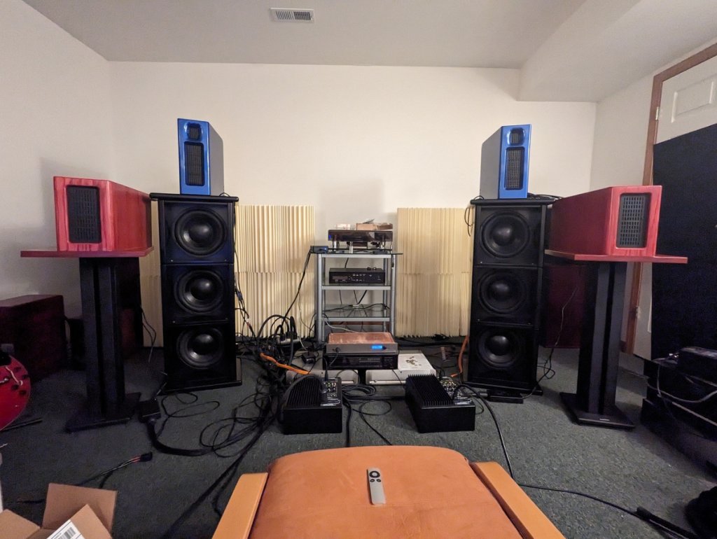

Just got an update that the EA dspNexus 2x8 will be here on Monday to begin use with the Magnetar II speakers for LSAF 2023.
An updated DSP XO is ready to try and measure with the front mic input and my Behringer ECM8000 with calibration data.  If that looks good will get out the Earthworks M30 mic and calibration data.  That worked better with my old DEQX 2.6P processor than the ECM8000.  Both work with 48V phantom power on the mic input.
Will post pictures once it arrives.

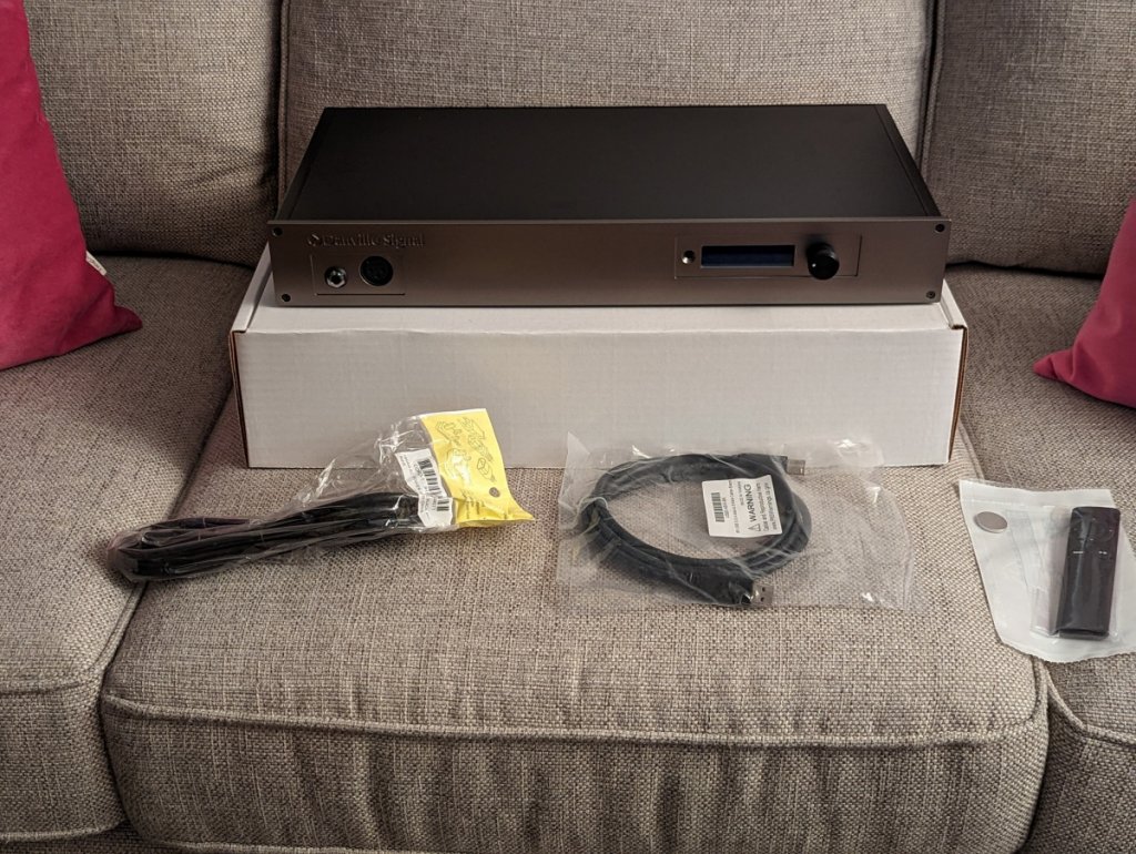

The first Early Adopter unit dspNexus 2x8 has arrived from Danville Signal.  The accessories are the remote, S/PDIF cable and AC power cord.  The battery is separate from the remote since it is always on.  Nice and fresh with the 30 second battery install.

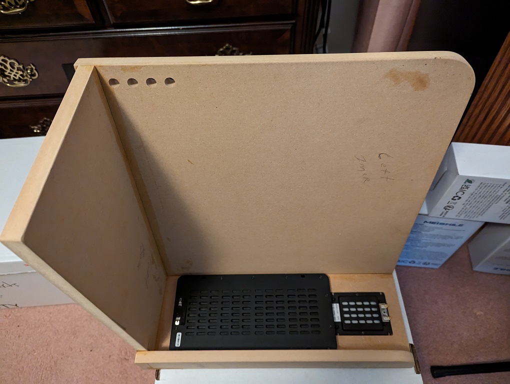

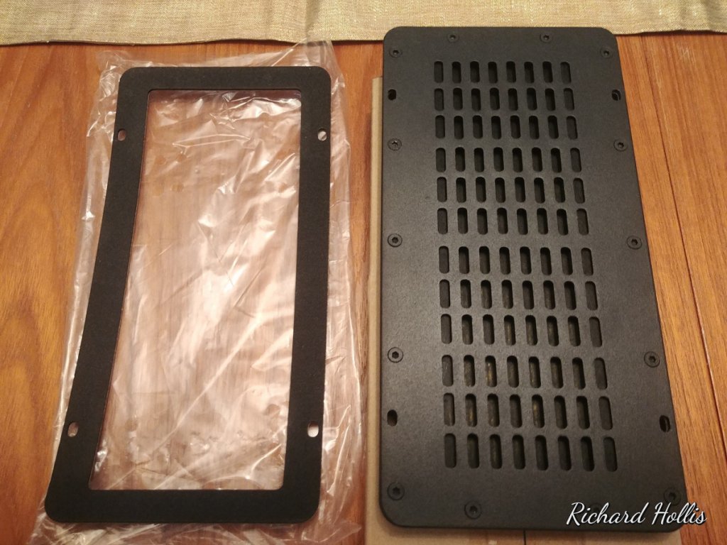

Will be getting the Magnetar II baffles back from rework for the new Radian planar driver as it is longer than the original mounting recesses.  Any future units have the CAD drawing updated for the new planar.
Looking forward to giving it a try as soon as parts are ready.

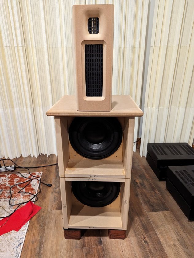

Another EA dspNexus 2x8 will be on the way soon to run a pair of GR-Research NX-Tremes speakers and a pair of OB 3x12 servo sub.
First step will be crossover measurements to replace the passive crossover with the DSP version to tri-amp the speakers and run the existing servo amps.  :)
