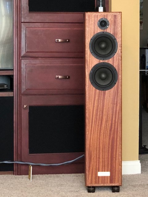

After conferring with Lou Hinkley at Daedalus and a few others about building speaker cabinets from solid hardwoods, I decided to build a pair of CSS-Audio Criton 2TD-X T-M-M tower speakers from solid quartersawn African mahogany. Lou is a first-rate designer and craftsman and he's been successfully building amazing solid wood speakers for years. I chose mahogany because of its excellent stability, and the ready availability of wide boards. I also added a Baltic birch inner baffle and Baltic birch inner braces, GR-Research No Rez, solid core silver wire from the crossovers to the tweeters, and solid core copper from the crossovers to the midwoofers. I used GR-Research tube connectors as the primary amp-crossover connection, but also jumpered them to high quality binding posts so I can use other speaker cables not terminated in tube connectors. I installed IsoAcoustics Gaia II feet. The cabinets are finished in Odie's Dark Oil and Odie's Dark Butter...and they look much better than in the photos here!
I'm VERY happy with both the sound and the appearance of the towers. Imaging is extremely engaging, and low frequencies are extended and tighter than I expected.
I will confess that I'm also using a pair of Take-T Live supertweeters, which are presently connected to those spare binding posts. I can't say how much they're contributing to the imaging magic because I haven't listened without them yet.

I'm jealous as all get out. I ordered these same speakers last Fall, but haven't been able to assemble them yet. [I hope to accomplish this by mid-June.] I've got the flatpack, but I plan to veneer the front baffles, and maybe paint the other surfaces (dunno for sure). That is a beautiful wood.
I've corrected the issue with photo #2.

Excellent job with the woodworking! Did you make any grill cloth rings? (it would be a shame to hide the wood).
Zuman
Thanks! I had help from a very skilled friend!
I did not make any driver covers of any kind. I agree that it would look cool to have flat black disks, but the midwoofer excursion would require an actual "standoff" frame, and I didn't want to make something and end up dealing with diffraction or veiling issues.
