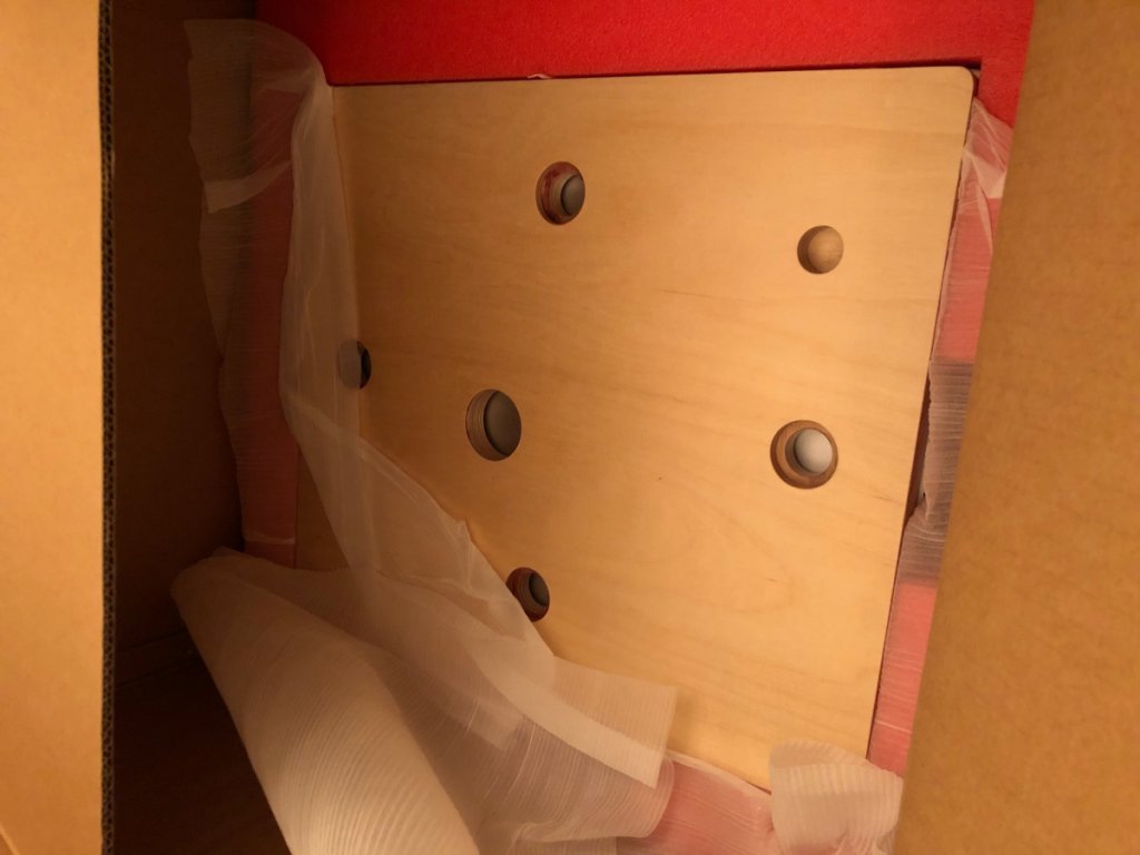

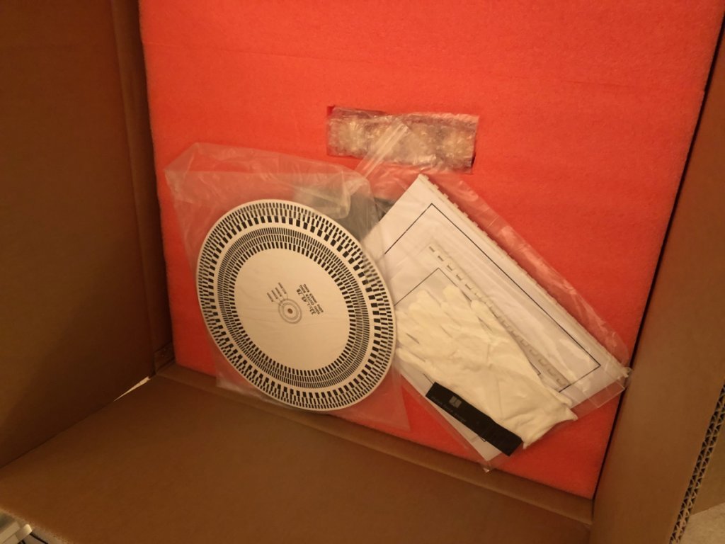

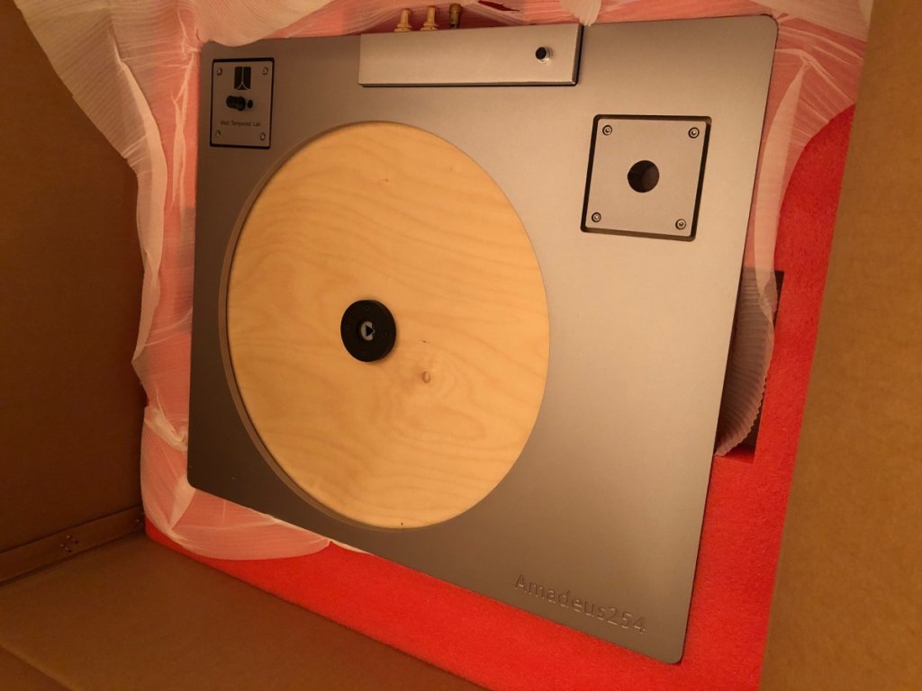

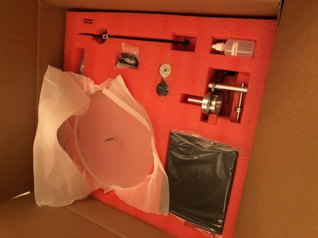

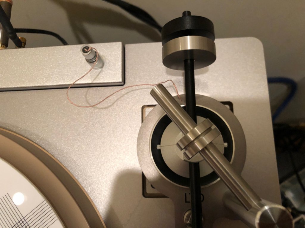

I finally have the 254 GT in house!  Mike Pranka received his shipment this summer, but because of my back surgery I needed to wait until recently to take delivery.
Set up was straightforward.  The plinth is two pieces:  a base plate that rests on 4 sorbothane feet, 4 squash balls support the top plate, add platter, tone arm, cart, and you are done.  Cart installation is stupidly easy with Well Tempered products.  Just screw it into place and it's finished.  The details of stylus rake, pivot centering, depth of golf ball into the goo remain, tho.
The VTF gauge provided is a balance which precludes hitting a precise tracking force.  I have a digital gauge on order and it will arrive this week. Tonearm set up will be tweaked as needed.
Initial impression:  My WTA was a quiet 'table, but the 254 GT is significantly quieter.  Better bass.  The WTA could be slightly raw at times and this has vanished.
The electronic speed control box is a godsend.   Speed fine tuning is easily attained by turning a knob.  No more blind fumbling with a small screwdriver in a hole on the back of the deck as with the WTA.  Very nice.
And, a spool of thread included that Mike says is different than what was recommended earlier.
Here are some unboxing fotos:
