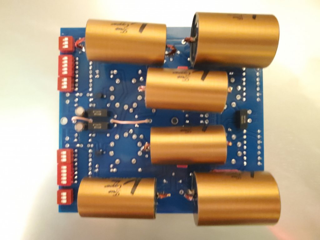

This morning I was finally able to plug tubes in and flip the power switch. To my surprise, the tubes lit up and no capacitors exploded. I am getting some feedback from the SUT so I will need to sort that out though. I currently have my dac playing through a reverse riaa converter into the MM inputs, and it sounds phenomenal. Once I chase out that last bit of noise from the SUT, I think I will be a happy camper.
On a side note, those Audyn caps are just stupid big. It fits, but it's like squeezing a V8 into a Honda Civic.
For reference, here is a normal board
And here is my board.
Here is a peek under the hood. Can't see much but the SUT is still in an aluminum case, the transformer is in a steel cover, and an aluminum partition (hidden by the screwdriver) between power supply side and main board.
And here it is all rocking & rolling.
The hum from the MC input into the SUT is going to bug me though. I've seen a few different build posts about this kit where they put a SUT into the case just like I did here. The weird part is I have the MM input wires go into the case and connect at the SUT output. It only hums when the cables are connected to the MC input. I'll still check cables and all the lading settings to see if that changes things a bit. Not sure though. Even still, this thing sounds stupid good so far testing with my dac I put to it.
