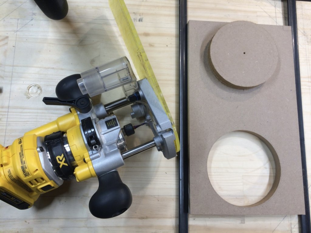

This is the 20v cordless Dewalt router with their plunge base.  The nice thing is the ability to put a dust collection system on it.  MDF dust is toxic, the the dust collection is important.  Dewalt does make a corded version of this router and I am sure there are other brands that would work well for this.

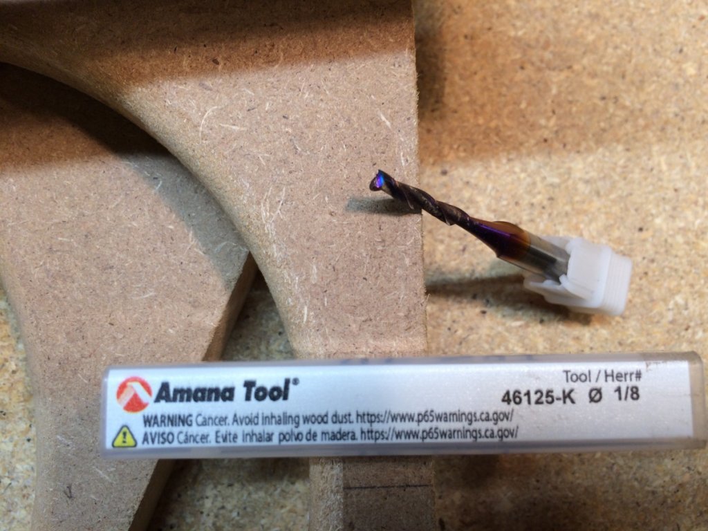

This is the cutter I use.  I see no point in cutting more than necessary; the 1/8” cutter works well for this.

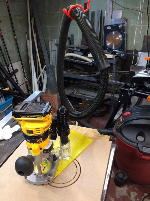

I have gotten a ton of use from this circle cutting template.  This just attaches to the router base and makes perfect circles.
This is pretty much the whole setup.
