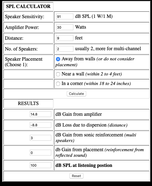

Thank you fellow members for some very intelligent input. My speakers are Audiovector R3 Signature(8 ohm), which are rated at 91dB sensitivity. My room is approx 12 X 18 feet. The speakers are 7 feet apart & my chair is 9 feet back. It seems the Pass Labs XA 25 may have enough power. The price difference between XA25 and XA30 is US 2,000, so my thinking tells me the XA30.8 is a safer bet. The other factor is that if my listening room were to change size in the future the XA30 would have enough power for a 35% bigger listening room. According to Pass Labs the XA30 weighs 88 lbs & XA25 weighs a mere 45 lbs.

With 91db speakers the XA30 with its 30 watts can deliver 100db at 9 feet (your listening distance). The excellent sound quality, however, comes from the CURRENT those huge transformers and Class A topology deliver to the speakers. Thats why it weighs 88lbs and sounds great! Here is the calculation:
