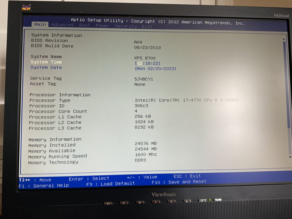

Trying to attach pix of screenshot with F2
soundofrockets
  • Posts: 403
Re: Dell XPS not starting
« Reply #15 on: 20 Feb 2023, 07:10 pm »
F2 screen shot
JakeJ
« Reply #16 on: 20 Feb 2023, 07:19 pm »
OK, almost there.
Note the tab or page in your screenshot says "Main".  You need to select the "Boot" tab two tabs/pages to the right.
Please give us a screenshot of that tab/page.
I fear WGH is correct and you'll have to decide whether to invest in a new drive or dump it on Craigslist.
Jake

WGH
« Reply #19 on: 21 Feb 2023, 01:02 am »
F2 screen shot

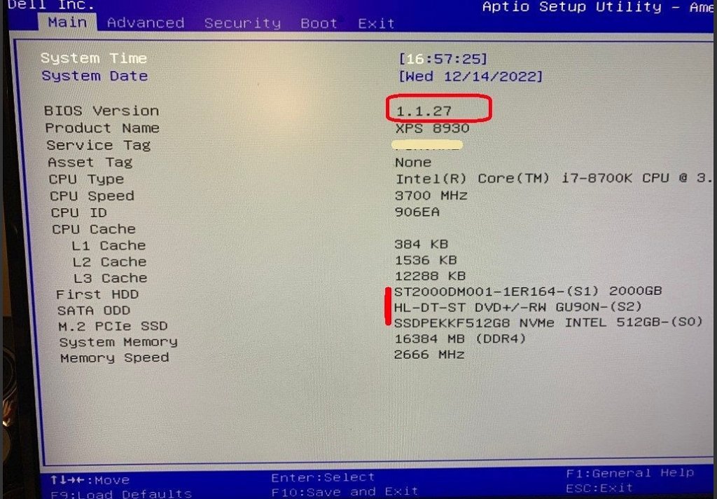

Need to see the bottom of the screen, notice the scroll bar on the right is at the top, slide it down. Looking for HDD numbers. Different BIOS lists the HDD ID info in different places, I never owned a Dell.
Just guessing but the bottom of the window should look something like this:
If you don't have any important data on this computer, I wouldn't put too much effort into solving this problem. At 10 years old it has reached the logical end of it's life, from now on the computer will have one problem after another. A year ago I replaced two computers, each was 10 years old. Connections get corroded, capacitors dry out, errors and reboots happen unexpectedly. Hard drives die.
