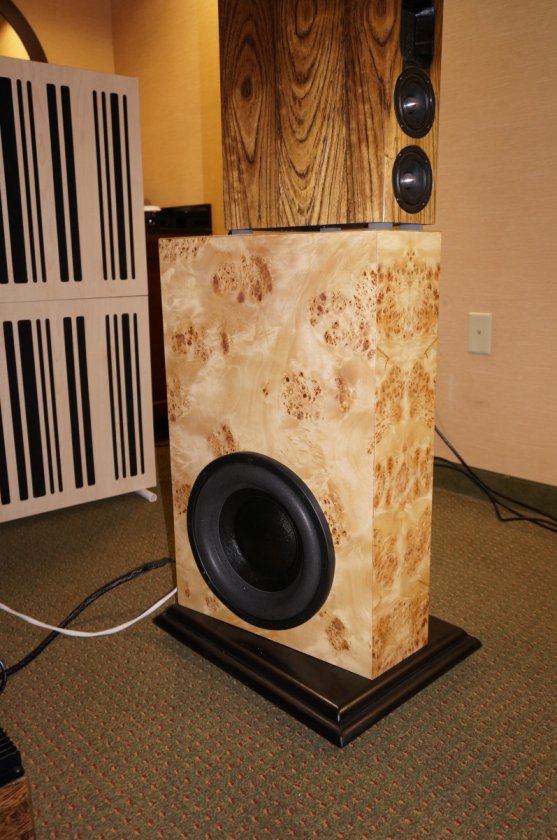

I can't speak to Ripoles, but I would caution against using too small of an enclosure for the servo subs.  I built a pair of the 12 inch servo's into a small modified U alignment for a build I was doing with the original Wedgies:
Its difficult to see but you can get a feel for where the drivers were with reference to each other and the size of the cabinet, really just large enough to house the drivers.  What I found with this cabinet was that the drivers would go non-linear when driven hard.  I can only attribute this to the cabinet, I am currently using the same amps and drivers for the H frames in my signature.  I ended up tossing these cabinets. I theorized that the front of the cabinet was becoming pressurized as compared to the back half so there was greater resistance to the cone return on that side of the driver.
Given my experience I would recommend building a quick and dirty test cabinet when trying to go small using these drivers.

I should have mentioned, others have had success with this modified "U" alignment using the servos, I believe there are several examples using the 8" drivers and I seem to recall that Mike has a set using the 12" drivers.  Those were similar in design but larger and as far as I know worked as expected. I believe more airflow is required even in a cabinet open on one end, my cabinets were filled by the drivers to the extent that the airflow was restricted from the enclosed end of the cabinet, further impacted by the asymmetrical enclosure as you mentioned, the cabinet getting smaller towards the enclosed end.
The concept can work, my application failed.
With regard to "W" alignment issues, I haven't built one but I believe the biggest issue is bracing the large open section of the cabinet while still being able to load the drivers into the baffle.

I had a set using the 12" drivers in a wedge shaped cabinet to better match the form of the Wedgies.
These worked pretty well, better than the triple 8's I had the year before in H-Frames
The triple 8's were really good but the two 12's were better which makes sense given that two 12" drivers have 50% more surface area than three 8" drivers.
To go with the Wedgie, the wedge design was fine though I would make all the dimensions and angles the same except the front would be a couple inches wider. This would give the upper driver a little more breathing room.
With the wider NX-Otica MTMs, the narrow wedge shaped base wasn't needed for aesthetic reasons so I went back to H-Frames. The same drivers and amps preform better in the H-frames than in the wedge shaped cabinet.
Using the wedge shaped cabinets with the Wedgies is a trade off. You give up some performance for a more pleasing look.
