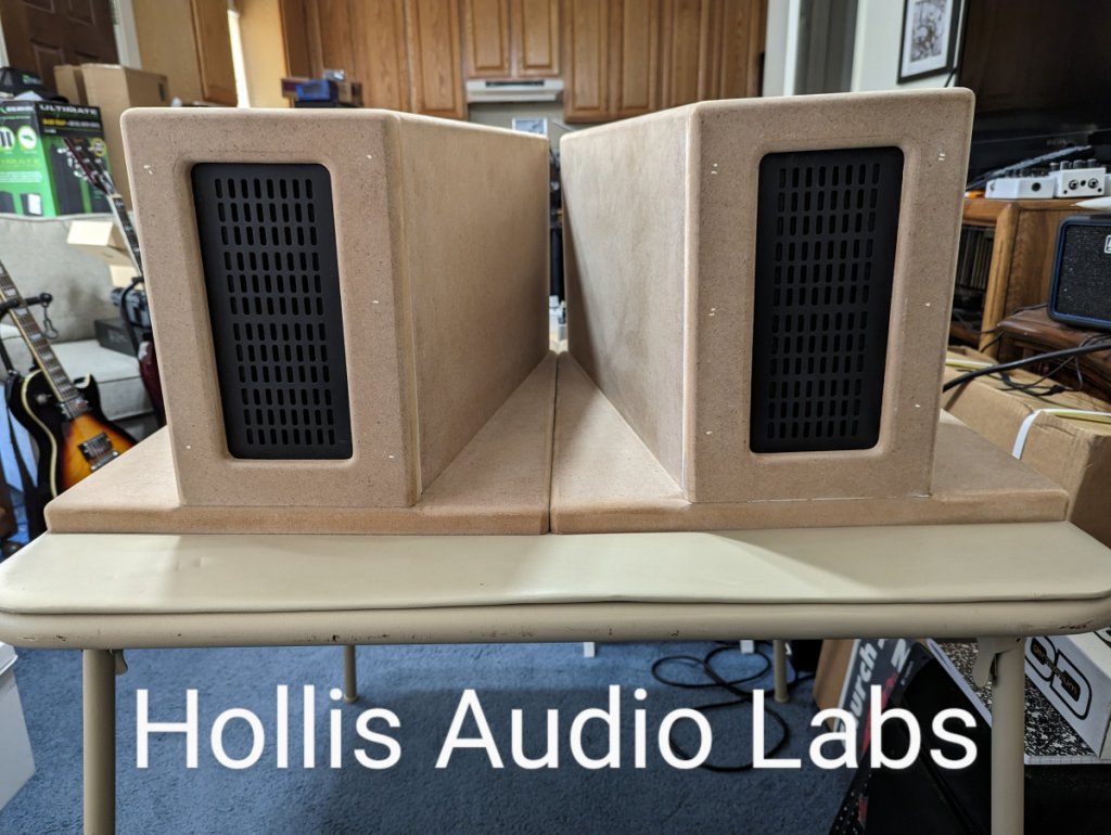

First test baffles for the HAL Magnetar II open baffle planar speaker.  Trying for 190Hz to 20KHz from a single planar driver.  Below 190Hz will be either a 2x12 of 3x12 servo sub stack.

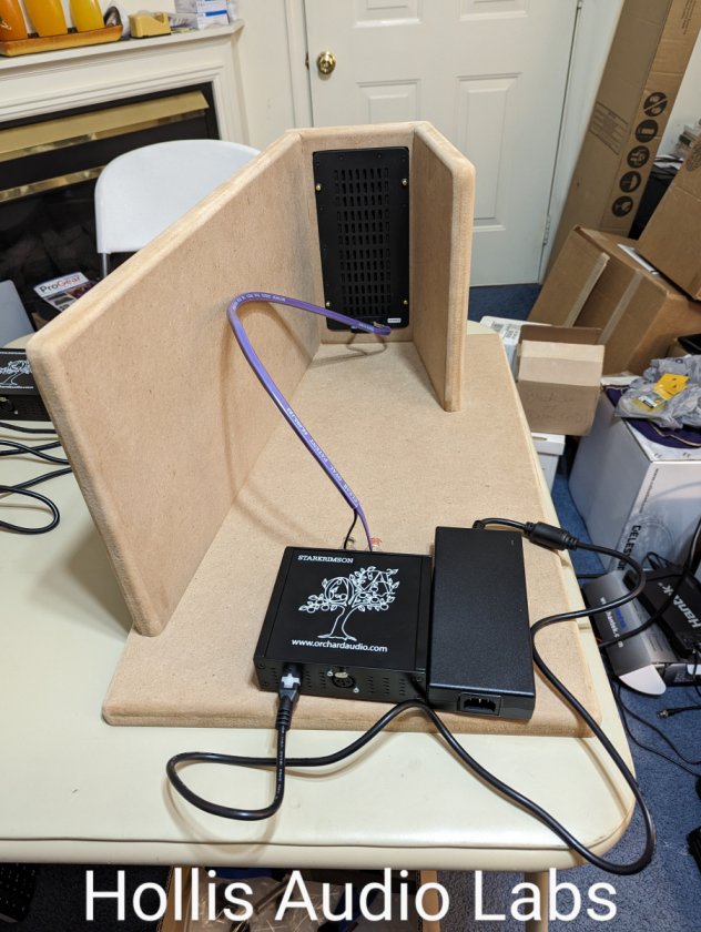

The HAL Magnetar II planars are wired up and the Orchard Audio Starkrimson GaN Class D monoblocks are setup for testing.
Next is DSP crossover setup for the dspNexus 2x8 for testing.

For reference to the earlier thread, this is the Radian LM10n planar installed in the baffle for testing.
Finishing up dspNexus 2x8 firmware testing, then back to testing the speaker.

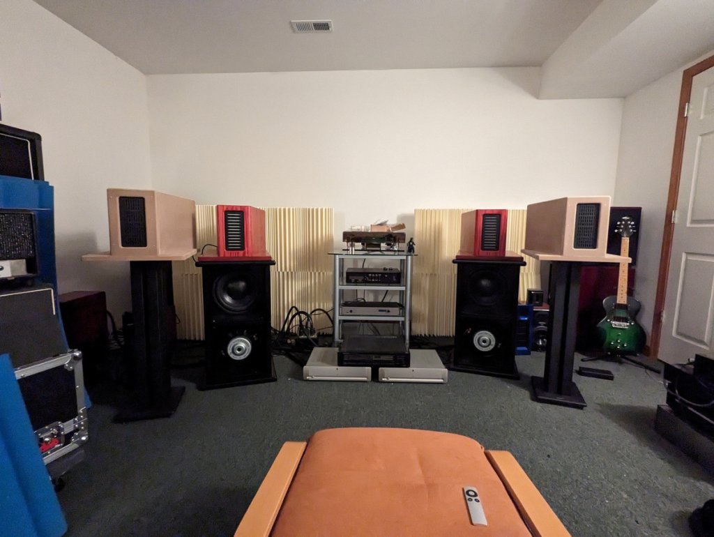

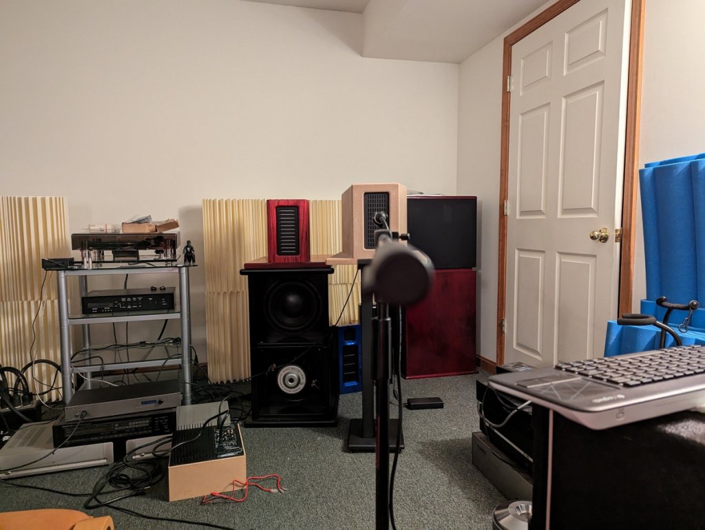

Starting tomorrow, testing of the Magnetar 2 speakers begins.  Will be using the new powered measurement mic option of the dspNexus 2x8 prototype as the latest firmware update has the options for use included.  Have a Behringer ECM8000 with calibration data files to try with Room EQ Wizard for the measurements.
The dspNexus 2x8 prototype is on the shelf waiting on balanced connections to the Orchard Audio Starkrimson monoblock amps connected with 2ft of Analysis Plus Clear Oval 14 speaker cable.  The monoblock sits on the end of the planar folded baffle.  An Intel NUC i5 will be running AudioWeaver for dspNexus 2x8 programming.
New room treatments arrive on Wednesday to install that are portable and hopefully going to LSAF2023 in Dallas, TX for the show.

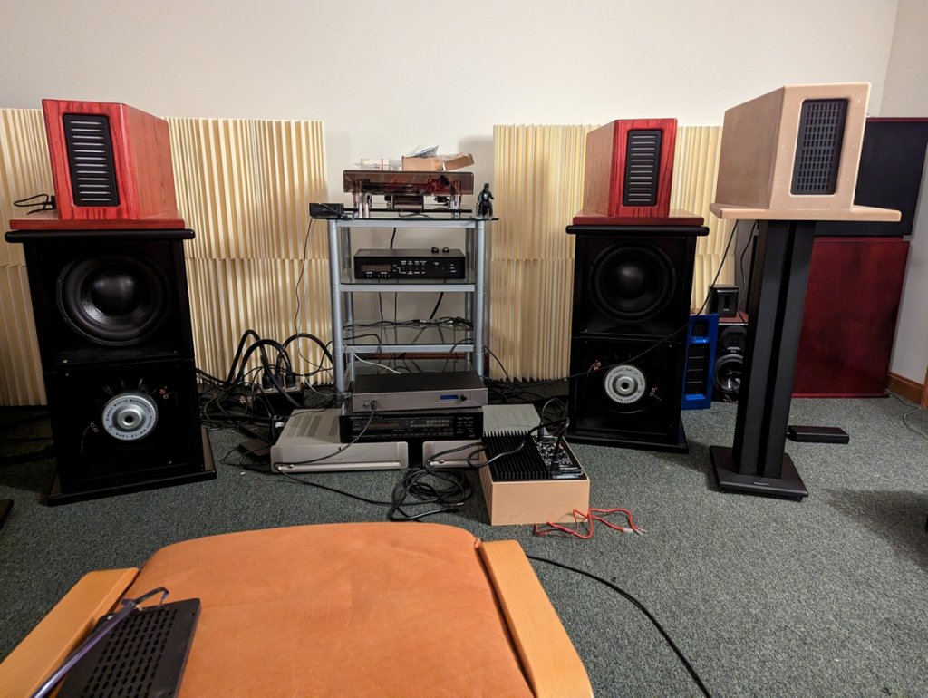

Have the dspNexus 2x8 connected to the Magnetar 2 monoblocks amp and new Rythmik Audio A370XLR3 Servo Amp. The Behringer ECM8000 is connected to the mic input for measurement use.
The mic ADC output goes to the USB2 output data for PC or MAC use with your measurement program. In this case will use Room EQ Wizard compared to CLIO Pocket system for crossover testing with the speaker.

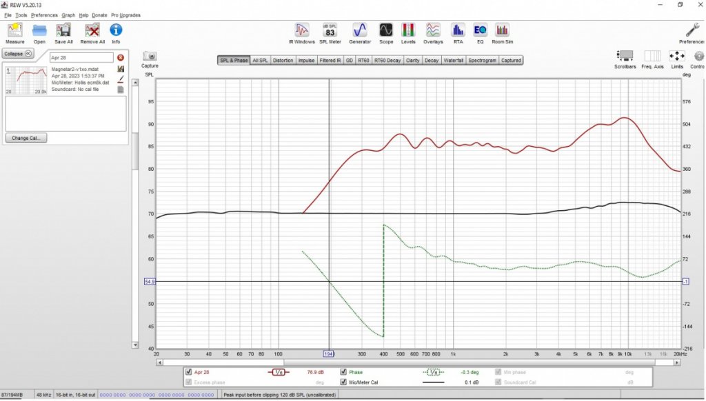

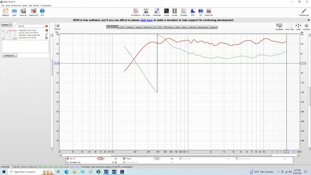

After the first round of testing and crossover develoment for the Magnetar II speakers, the single Radian LM10n now has this frequency and phase response.  The major divisions on the graph are 5dB.
Next will be testing the servo sub stack to set the DSP crossover to the LFE input of the Rythmik Audio A370XLR3 servo amps for the open baffle H-Frames.

« Reply #18 on: 1 May 2023, 01:30 am »
Impressive results!!
What was the raw response like of the driver before correction?
HAL
Re: HAL Magnetar II baffle testing
« Reply #19 on: 1 May 2023, 02:18 am »
This is the before with just a high filter and baffle step correction in the baffle.  Would be interesting to see someone attempt this with a passive XO.  The Radian LM10n also appears to have a version of the BG NEO3 style PDR capability to widen horizontal dispersion.  I see no need for a tweeter with this planar in the baffle.  I listened to the planar speaker without the final corrections and it had a wide horizontal dispersion.
