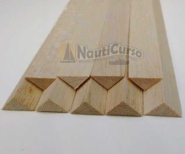

1) Round off all corners with 30/40mm triangular wooden profile.

What is meant by "round off all corners with 40mm triangular wooden profile"?

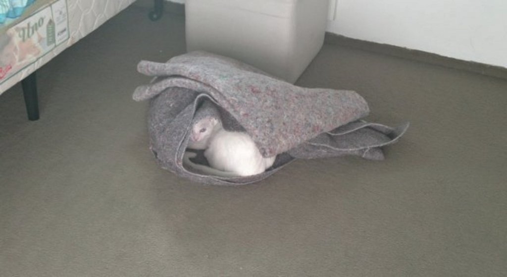

If you want more bass add some car wood 15/20mm blanket on the enclosure back.

Those who work with FG must wear mask, gloves and special clothing because the particles released can cause irritation to the skin, eyes, and respiratory system, so in a short time I worked with car audio I discovered that engine hood blanket is much better and cheaper, creates more bass, last longer and is non-toxic.
