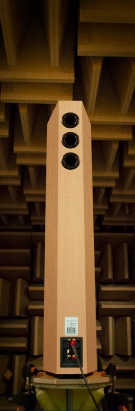

Hi Speed - in our case we have a very large factory anechoic chamber for testing our speakers and Voicing is something we try to avoid as best we can.
james

Sorry. I used 'Voicing' as a synonym for tuning (or maybe calibrating). Some brands use skill and high-tech and some others not so much.
But you do use speaker cables for these tests, don't you?

H
Yes very short and generic
