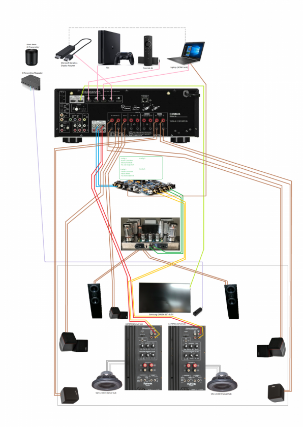

I have been working on / off on my audio room for a year now.  And keep bumping into an issue with my design.
I purchased a Yamaha vsx-9040txh for the surround function , ease of connection, and not amplifier. But this is where things get weird.  The Yamaha clips and goes into protect mode when I play louder , anything past +1.. which is 90-100DB..so loud... but when I am not even pushing load on it (It has no speakers attached when in Stereo mode), that is annoying.  I contacted Yamaha and they were polite, but in summary...  "that is not what we made it for..."  and so I am on my own.   I am not EEE... but keep digging around and think the solution may be simply to put some dumby speaker load connections on the right/ left front speakers.  https://www.amazon.com/gp/product/B08D3GJGP7/ref=ox_sc_act_title_2?smid=A305CAEWZPRP7E&th=1

Your diagram is illegible.

My bad on posting about receiver.  It is a Yamaha TSR-7850  (Pioneer got fried in storm..)
And the output from reciever is pre-out RCA connections that go into MiniDSP 2x4HD in diagram but I am upgrading to a new MiniDSP Flex (same concept but I can use highdef bluetooth streaming.
But load question really was about Yamaha.   The pre-out RCA connections, when I play at higher volumes... put the amp into protection mode as it sees no load..   So would adding those dummy loads eliminate this without hurting the amp.

Your diagram shows you also have the subs double connected when you don't necessarily need to. That may be causing the problem. If running them off the dsp, don't connect them to the subwoofer outputs from the receiver. It shouldn't create a problem, but could be making it wonky. Run them just off the dsp connection, set the receiver to no sub and full range output on the front main preouts and see what it does. 🤞
Next option would be to diy a speaker level to line level converter with couple resistors and run your setup that way. It'd be using front speaker outs, speaker wire to binding posts on a small box, resistors to drop the level, then rca outs to your dsp. A little funky and a lot of connections in the signal path, but equally effective in a pinch. I did that to run my subs off my tube integrated, and did it again to run my headphones through there as well.
