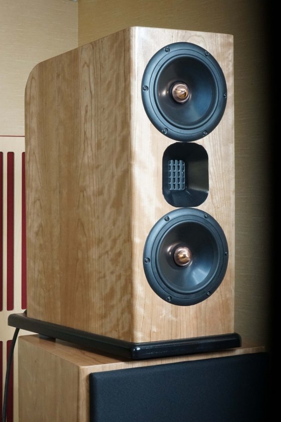

Hobbsmeerkat
  • Posts: 2741
Re: NX-Treme for surround system?
« Reply #5 on: 24 Jan 2023, 11:03 pm »
Here is a better look at them
asdf
Dang Hobbs, that looks great! What is it?
Bob

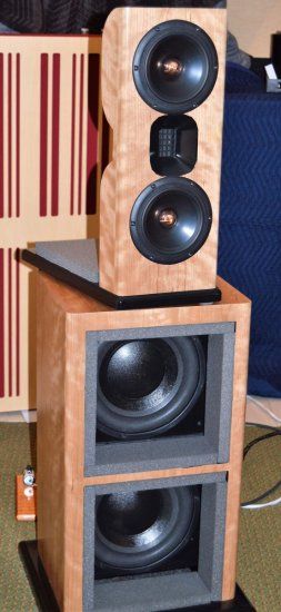

Hobbsmeerkat
  • Posts: 2741
« Reply #11 on: 1 Feb 2023, 09:00 pm »
That's our old NX-MTM sitting con a pair of double subs.
Basically just the upper section of the NX-Otica.
We don't offer it as a kit anymore, as we have plans for a design with three 8" subs instead.
It will be a single tower rather than a 2-piece setup.

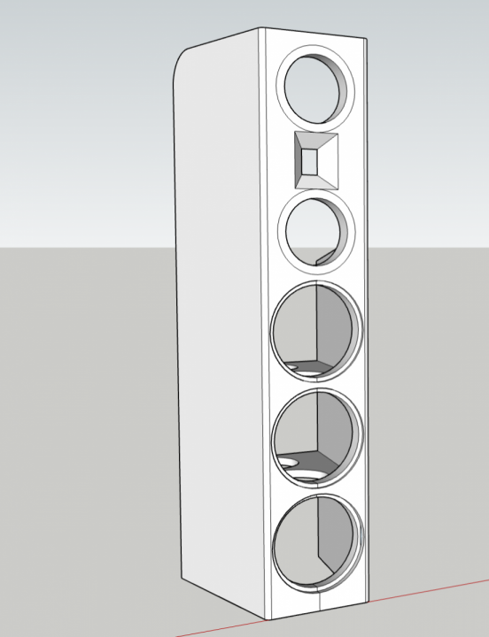

Hobbsmeerkat
  • Posts: 2741
« Reply #13 on: 2 Feb 2023, 12:43 am »
We're still working on it and He's given me some ideas for how we can address the wider baffle, but heres the starting design I've done in SketchUp.
It will still be similar to the Otica, but wider with 3 subs instead of 4 woofers.
Ill be tweaking the design further until we get something were happy with.

Hobbsmeerkat
  • Posts: 2741
« Reply #15 on: 2 Feb 2023, 01:36 am »
Oh that's going to be very cool.  With this I assume you won't need the separate 12" sub stack like you do with the current NX-Oticas, is that correct?
Yup, it's intended for those with limited space, where separate tower's aren't possible. Similar to Mike's MTM+ dual sub towers, but with a more cohesive look from top to bottom.
BrandonB
  • Posts: 528
« Reply #16 on: 2 Feb 2023, 02:03 am »
Will the 8's be servo controlled?
Hobbsmeerkat
  • Posts: 2741
« Reply #17 on: 2 Feb 2023, 02:22 am »
Yup
BrandonB
  • Posts: 528
« Reply #18 on: 2 Feb 2023, 11:39 pm »
So I am curious what the difference would be in the sound of the NX-Otica's with subs and This new design.  Do you think they will have as good of soundstage and imaging?
Hobbsmeerkat
  • Posts: 2741
« Reply #19 on: 2 Feb 2023, 11:51 pm »
She sound will be similar to the NX-Otica down to about 150Hz where the subs will begin to take over.
This design will have a larger round-over on the upper section to allow them to image just as well as the original design, the above design is a rough first-draft.
I'm still tweaking this cabinet to get the design were looking for.
I've already spread the 3 subwoofers further apart in the current draft to give them space for round overs, the design will likely need some additional bracing, as well as a few other tweaks design ideas to implement some of the other ideas we're considering.
