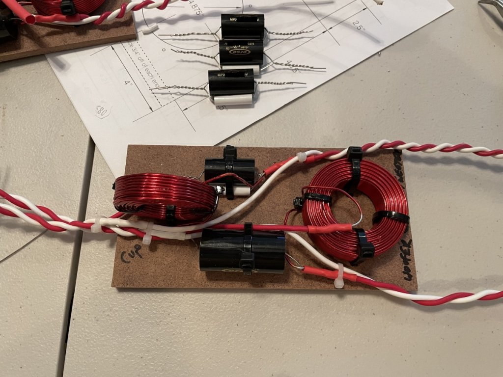

Got all the drivers wired up. I ran the tweeter down the same side as the low end drivers, hope that's okay in terms of cross talk.
How does my crossover layout look? There's so many inductors it's hard to keep them seperate.
corndog71
  • Posts: 1805
  • Some people call me Rob.
Re: Yet another NX-Otica Build Thread

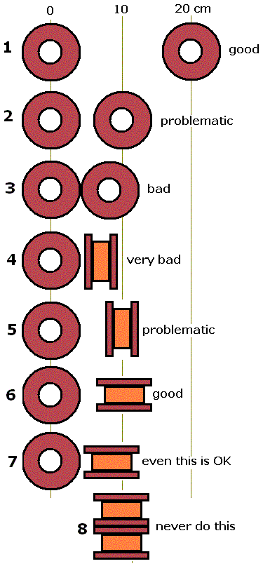

« Reply #12 on: 30 Jan 2023, 05:57 pm »
Mount the small inductors at 90° to the large one and space them apart as much as possible.

Finally finished the crossovers. Also I've cut up most of the norez to fit. Question, does the small wing at the top need norez?
Sorbothane disks on the bottom of the crossover board.
« Last Edit: 24 Feb 2023, 02:41 am by g3rain1 »

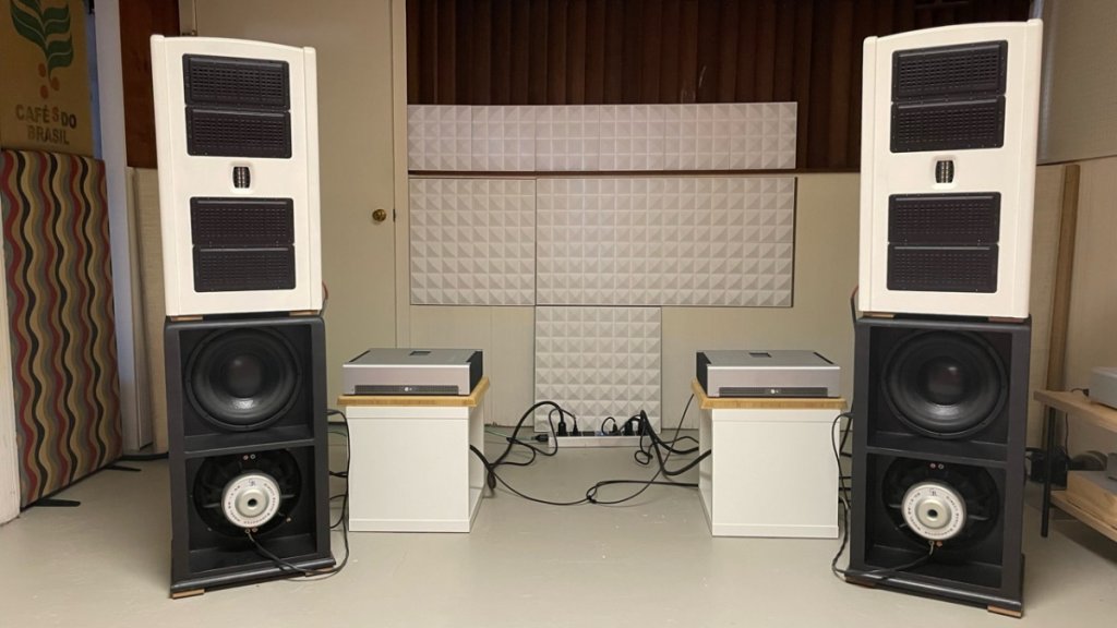

Finished and in room.
Now to get some amps worthy of these...  What do you guys think, Burson timekeeper 3X GT, Schiit Tyr, PS Audio M700, Orchard Starkrimson, Benchmark AHB2?  What are other Otica owners running?  I'll probably get a Holo Spring 3 KTE DAC down the line as well.
