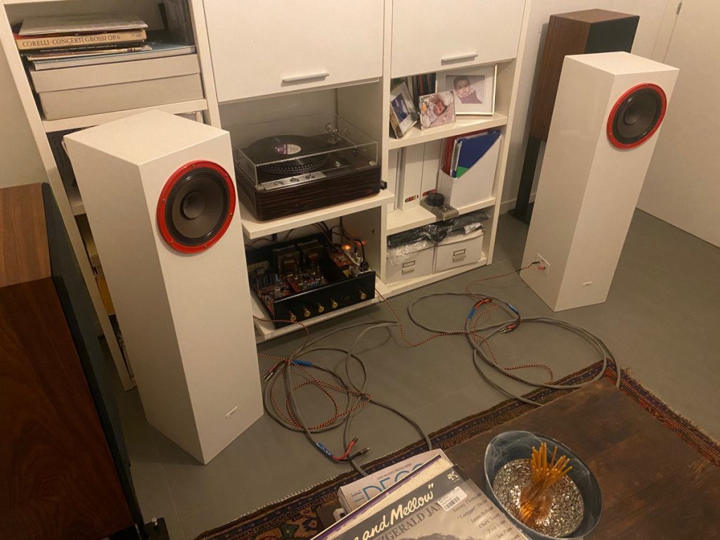

Unluckily I have no much space as you can see and, moreover, there is “mein Fuhrer” at home that I don’t think will accept something like these…

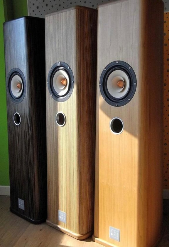

No problem for difficult cabinet. I like towers (for example the one in the pic that uses Fostex 103)
But I’m wide open to any good idea!
