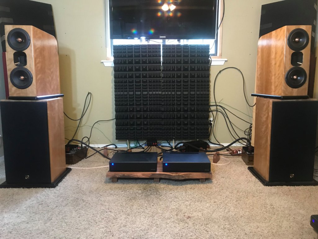

Thanks for the photo- how did it change the soundstage from when you had the 6A GIK panels?

Better depth and a more open sound. I felt the GIK panels were muffling the sound a bit.
https://www.atsacoustics.com
I still use GIK corner bass trap which I find effective. It was easy to sell my GIK panels. I listed them here and they sold the first day.

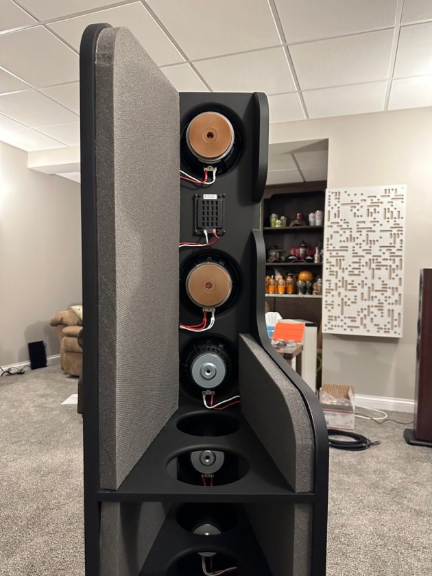

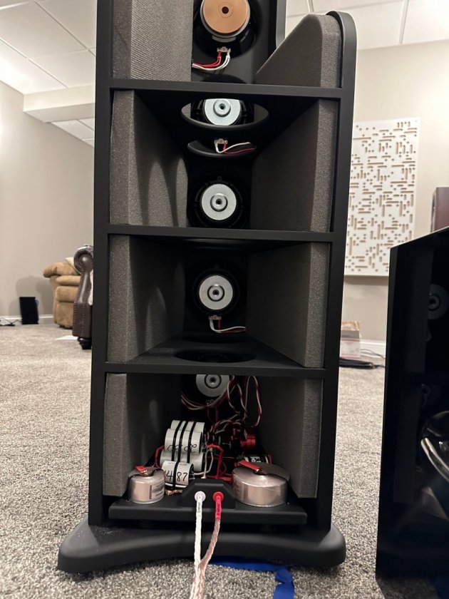

Thanks for putting together such a great post on your speaker build.  The pictures are very well done.  This will be a big help to others in the future.  Do you have a few more photos of the back of the finished speaker which show more details of how the No-Rez is installed?
I like the techniques you used to route the copper foil inductor connections to the crossover circuit.  It looks very neat and protective.
Congratulations!

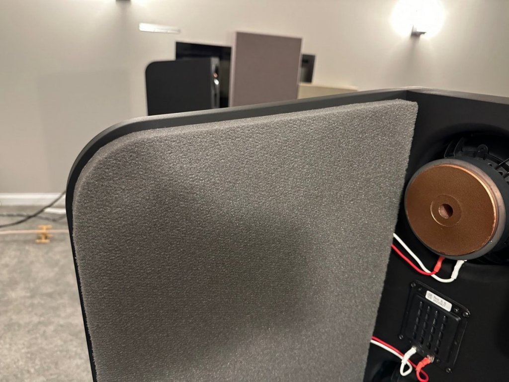

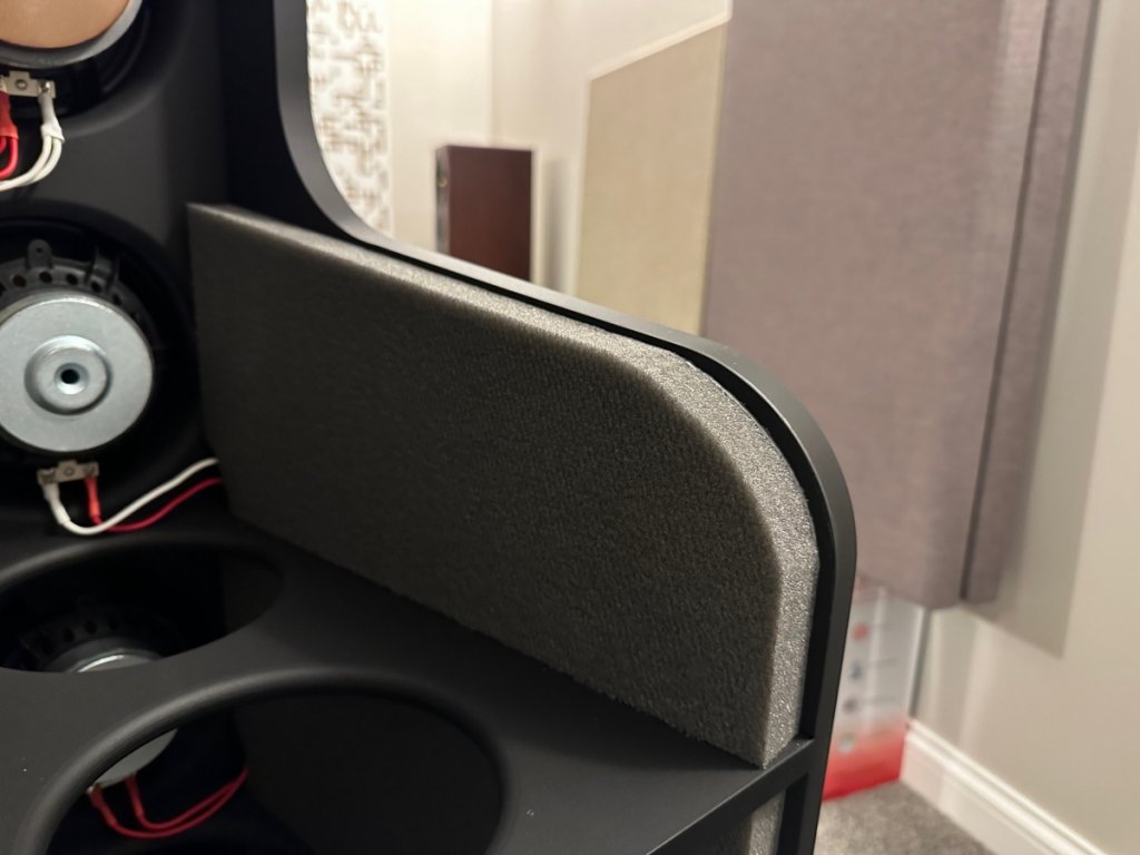

Sure- here are some close-ups of the rears.  I left about a 1/8-3/16" reveal from the edge of the wings to the No-Rez.

Equisit builds, love that mat Black look, what did you use to cut the ro-rez?

I used my table saw to cut the no-rez to nominal sizing- then found some round objects around this house that had the same radius as the tops of the wings, used that for tracing curved my line, then used a jigsaw with a fine blade to cut the round edges.  For the non-parallel edge cuts I used my track saw.  All of those three cutting methods cut very well with a nice smooth finish.
