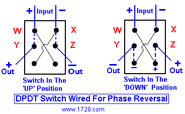

Yes, it would be straightforward to wire a Felicia as above -
1. The 'normal', 'reverse' phase switch(pink) would be configured as below (though I don't know whether it applies to the output or input)
2. The (baby blue) switch for output configuration would use a spdt, center off, switch, assuming your output is 'center tapped' hooked up as follows -
a. In the up position, ground, the green terminal, is connected via the switch to the center tap giving balanced/technical power.
b. In the center (no connection) the ground is hooked up to nothing for floating/isolated power
c. In the down position, the ground is hooked up to the 'bottom' of the output winding, re-bonding neutral to ground.
3. The yellow switch is an spst switch acting on the input. In the up position it connects the ground (green terminal) to nothing. In the down position it connects (re-bonds) that ground terminal to the input wiring's neutral. This, IMO, is unwise. If your outlet is miswired, its going to connect hot to ground, and will (hopefully) simply trip your that circuits fuse/breaker. If it is connected properly, it will re-bond neutral to ground, which is what neutral was set to in the first place. It may potentially cause a 'ground' loop.
You MUST fuse both inputs and output of both lines appropriately, 'hot' and 'neutral' (or fuse the inputs and put a GFCI on the output) of this unit, if you want a modicum of safety.
