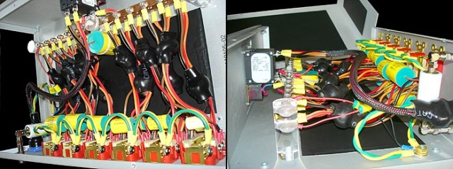

Here is the just released picture of the innards of the Audience Adept -
Input to a large Auricap as an 'X' cap accross the line (and that passive partial powerfactor correction), with 2 smaller Auris, 'Y' caps to ground from live and neutral. From there, the Live-Neutral lines branch to individual common mode chokes and then to their individual outlets, each bypassed, L-N, with additional Auricaps. And of course, the obligatory crimp on connecters.

      Getting a look inside the Adept Response was the inspiration for the additional caps I've been using across the output transformer. If you look at the pics, you'll notice that the caps across the receptacles are of differnt sizes (and values). In the Adept Response, they run from 1.0 to .22 uf. I'm sure their reasoning for the different values is to accommodate the needs of different components. How one figures all the combinations and permutations out is beyond me. At any rate, I chose a .47 as it was in the mid-range of their values. The additional bypassing provides added refinement, which they didn't find necessary, probably for financial reasons only. For their additional $10 cost on a $3950 unit that decision flies in the face of reason. I've heard what the output bypass caps do to the Felicia.
