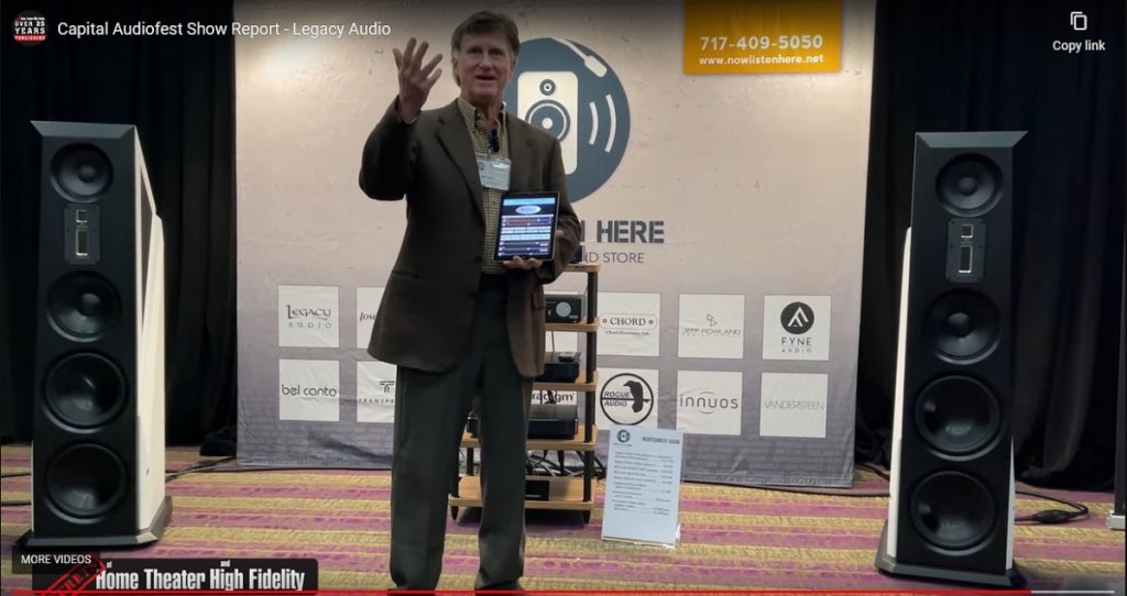

The Aeris is a "Directivity Controlled loudspeaker" so you should have a good image when listening off center. Legacy's Bill Dudleston explaines the Wavelet DSP:
https://youtu.be/Z0cuiVmS2BE
Looks like 7'- 8' apart with slight toe-in is what Legacy uses in their demo setups
