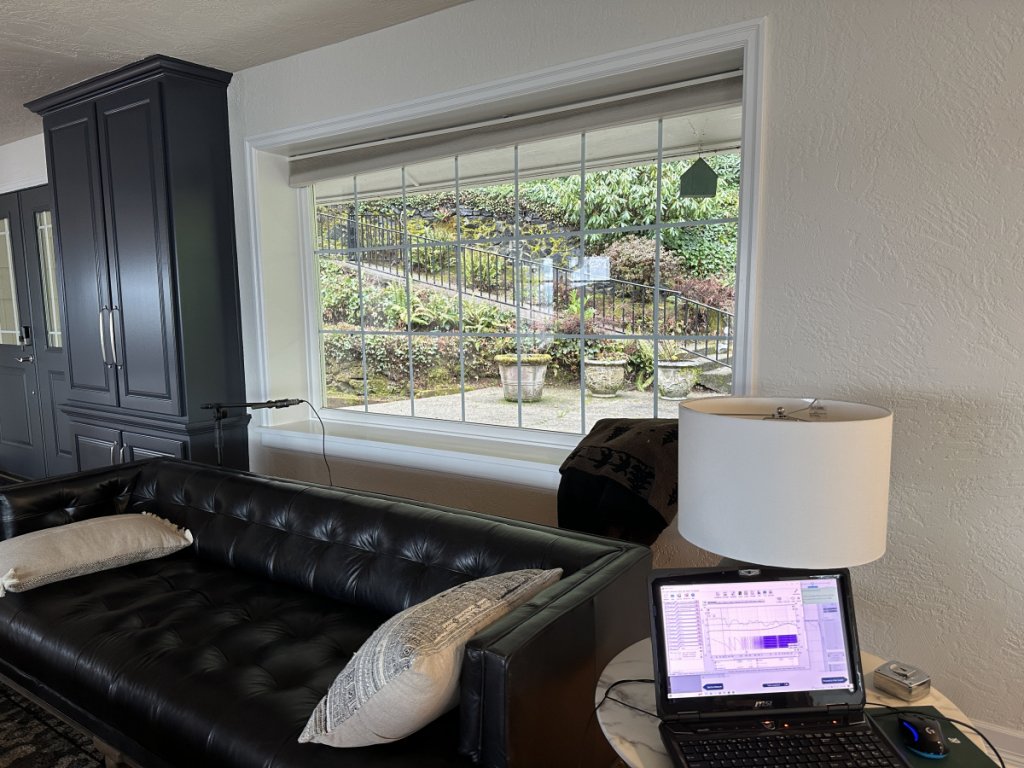

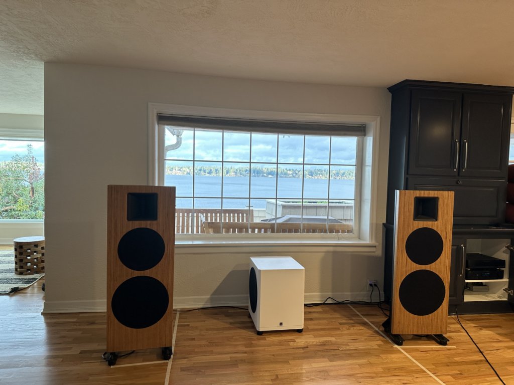

Hi all,
The Arendal 1723 2s sub is unboxed, and tuned for the room and the X3s with REW and dirac live 3.  The sub is definitely the missing link. It seems like a perfect marriage. The sub is flat from 16 to 100 hz in this room with only having to adjust phase to get there.  Can’t go wrong with this sub….dirac live also helped a lot in getting it close to perfect without installing acoustic treatments (wife still loves me).
Details: The preamp is NAD C658 (bluos streamer plus dirac live on board.
The amp is a Parasound A23+ (Class A/AB).
How I got to an “end point”.
Unboxing sub- beautiful experience white glove and all even though I didn’t use them.
I moved the sub in a position between the X-3s and slightly behind.
I opted (for now) to connect via RCA to preamp…. More on that later.
Next was to power on and see if it made sound.
Before moving speakers around I opted to do some SPL volume matching between sub and X3s as we all know every sub out is different for every pre amp.
With sub off, i sent a 50hz test tone to X3s and with meter (radio shack oldie but goody) directly on the grill I determined a reading on the left of 85db and dialed in the right speaker the same way (done previously so no change).
I then turned off the X3 bass amps, opened bluos app to tell the NAD I had a sub and crossed it at 100. I opened the Arendal app (yes can control everything via app over bluetooth). I sent the same 50hz signal again and upped volume on sub to match SPL I got from X3s. As is typical for NAD I needed quite a boost… i had to utilize the +6 db input gain and also turn it up an additional 14.5 db. I have not touched it since and I do believe this step is skipped by many and it’s important to marry the mains and sub.
The next bit took awhile… measured out the room and moved the X-3s from the wall in 6” increments and measured REW without sub. Surprisingly I got best measurements less than 1/5th width from wall. I have effectively no side walls as this room measures 100+ feet wide.  Next was sub by itself and REW and moving sub away from the wall but directly between X3s in 6 inch increments and phase 0,90 or 180 looking for max spl over 20 to 100hz. I settled on 8 inches and phase 180.
Next I tested crossovers (utilizing NADs or Arendals)… this is where it gets tricky as my endgame was to utilize Dirac live. Many of you will likely disagree with this next bit but I ended up crossing out the X3s at 100hz. It sounds best both by ear and by REW. It could be room specific and/or the crossover slope in the NAD (dont know if it’s 24,18,12 or 6db slope) but it sounds great.
Next I utilized Dirac live 3… I took many measurements choosing wide sound stage…. And saved their default, a +5 db bass boost (where I boosted 20 to near 150hz
 and then did a deep dive choosing all my own points to adjust and saved 2 more filters after assesment with REW. I am very happy where it is now…. Only took 3 days! 😂
I will post a pic if I can.
