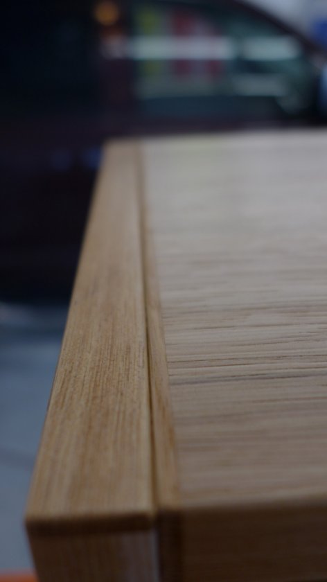

Honestly, I chose this design because I liked the form factor of a small tower and I wanted to bring my own interpretation to it the woodworking end of it. I've probably had the parts for at least a year and just tinkered with it in Sketchup and Aspire whenever the mood struck me.
I first heard of furniture joints in cabinet shop job years ago. It may well be a misnomer coined by the guy I worked for.
In essence, the junction where two pieces join is not flush but rather has a groove or some detail that conceals any misalignment. My thought was to mimic this, but on a smaller and more refined look.
In this case, I cut a 3/32" roundover on all edges before assembling. It's my interpretation of the look without the sloppiness that's inherent in inexpensive furniture. As it turns out, it was a little difficult because glue squeezeout had to be eliminated so it didn't foul the joint..   Here's a couple of close-up photos that might explain better.

I see it (the joinery technique you used) now. That adds a beautiful an elegant touch to already beautiful cabinets. The closeup photos remind me of a teak credenza my parents bought in 1978, and kept until they passed a few years ago. The credenza now graces our master bedroom.
I imagine the cabinets took more effort and attention to detail than slapping MDF panels together followed by a veneer cover glued on.
Very nice effect!.
