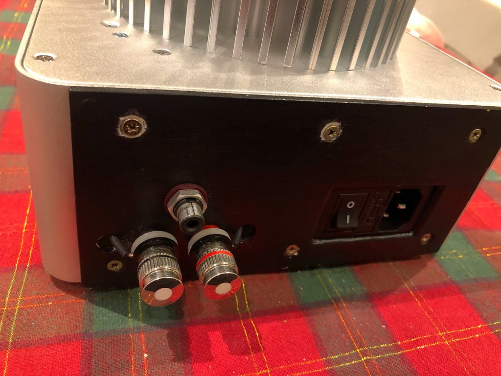

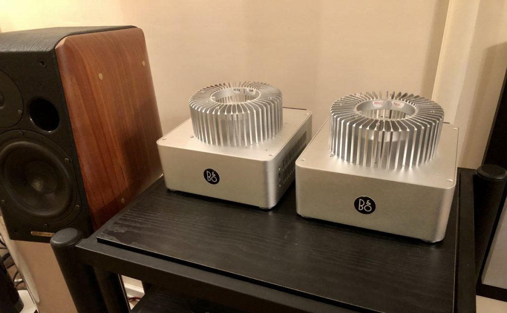

Below is an actual photograph of my completed monoblocks. Note that I purposely attached some aftermarket B&O stickers to the front of the aluminium cabinets, mainly for the purpose of covering up holes in the metal chassis where a button was originally mounted, and also because I happened to have the stickers laying around the house.

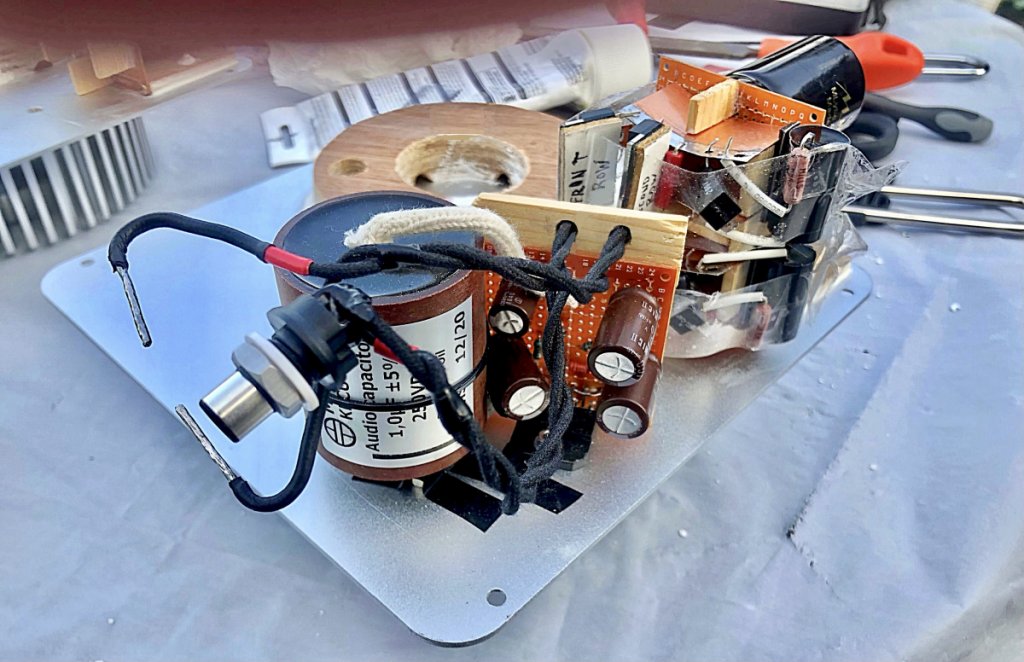

Credit goes to Jeff for helping me compile the list of components; including his recommendations for the circuit layout
After I did all the basic engineering of the chassis/fitting all the relevant parts onto it, the amplifiers were then sent to my friend Brent Rowe at www.fidelityaudio.com who ensured that everything was correctly wired together, and working properly. He performed all the relevant electrical tests etc, to ensure that the finished amplifiers were fully functional.

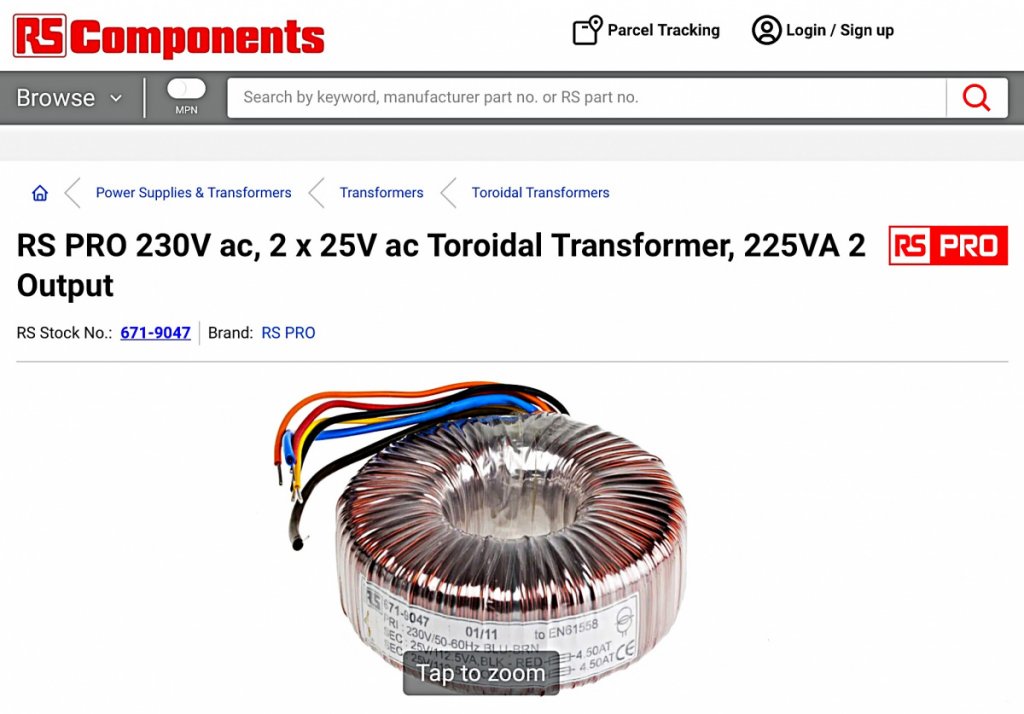

‘TWO’ TOROIDAL TRANSFORMERS - 225VA / 2x25V (DISPLAYED BELOW)

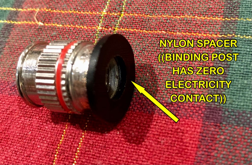

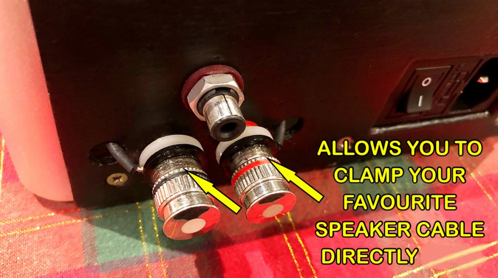

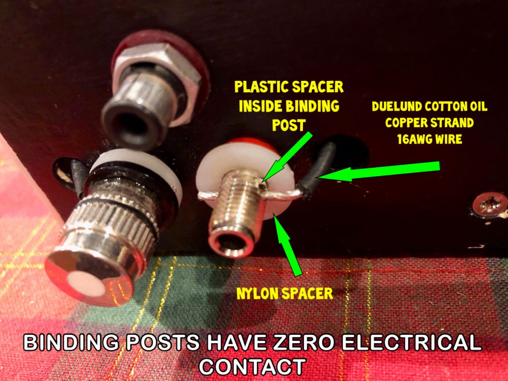

FOUR NICKEL PLATED SPEAKER BINDING POSTS
((Used only as clamps // Completely disconnected from the electrical signal)).

16 AWG DUELUND COTTON/OIL STRANDED COPPER WIRE
((For jumpers that link both the RCA Socket and Speaker Binding Posts to the main board)).

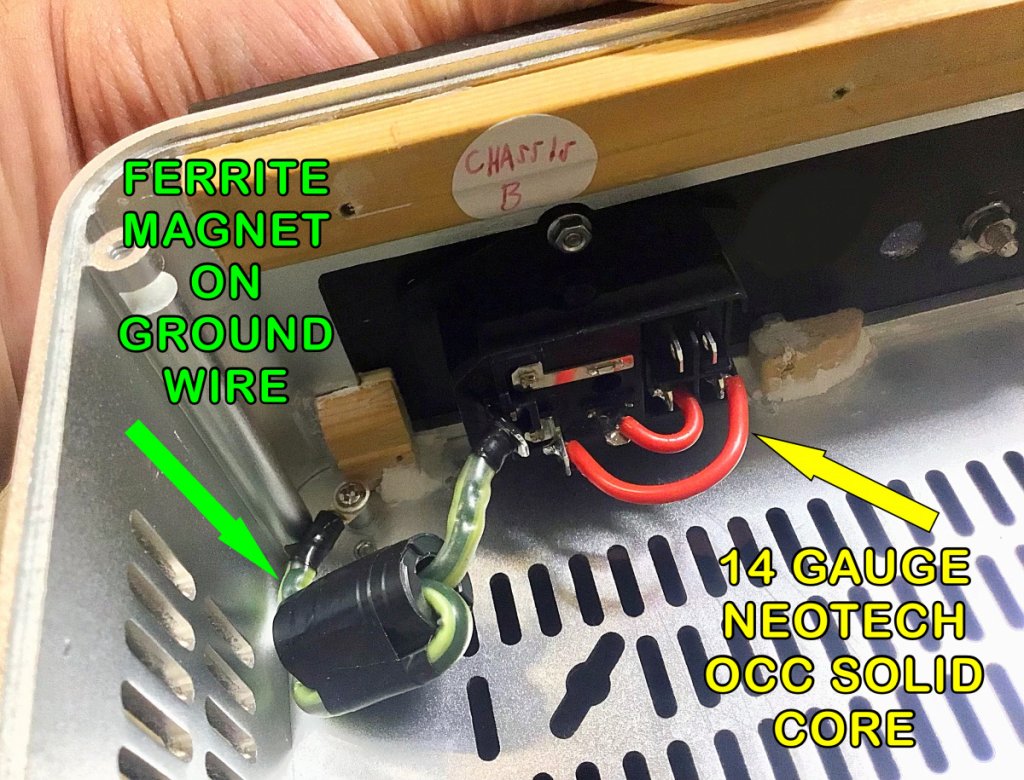

14 AWG NEOTECH UPOCC COPPER SOLID CORE WIRE - 99.9999% PURITY
((For IEC Socket jumper bars)).
13.5 AWG SUPRA LORAD STRANDED COPPER WIRE - 99.999% PURITY
((For IEC Socket ground wire with ferrite magnet))

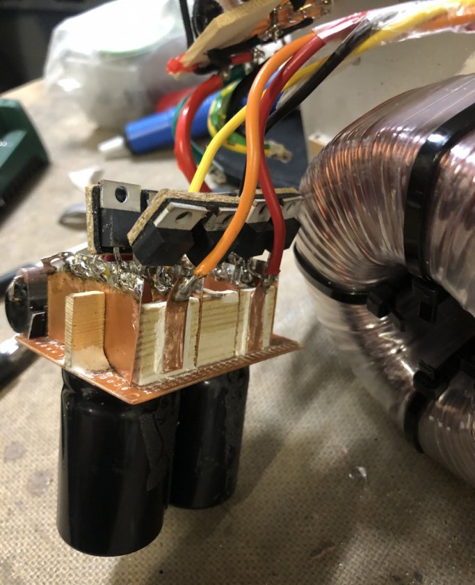

‘SIXTEEN’ FAIRCHILD STEALTH DIODES - 15A / 600V
((For Rectifier bridge)).

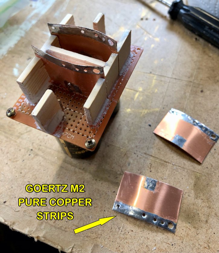

GOERTZ 99.99% M2 PURE COPPER STRIPS - “EQUIVALENT TO 10 GAUGE WIRE”
((For rectifier board / To mount components onto)).
That looks pretty cool!! it kind of reminds me of a slide projector.

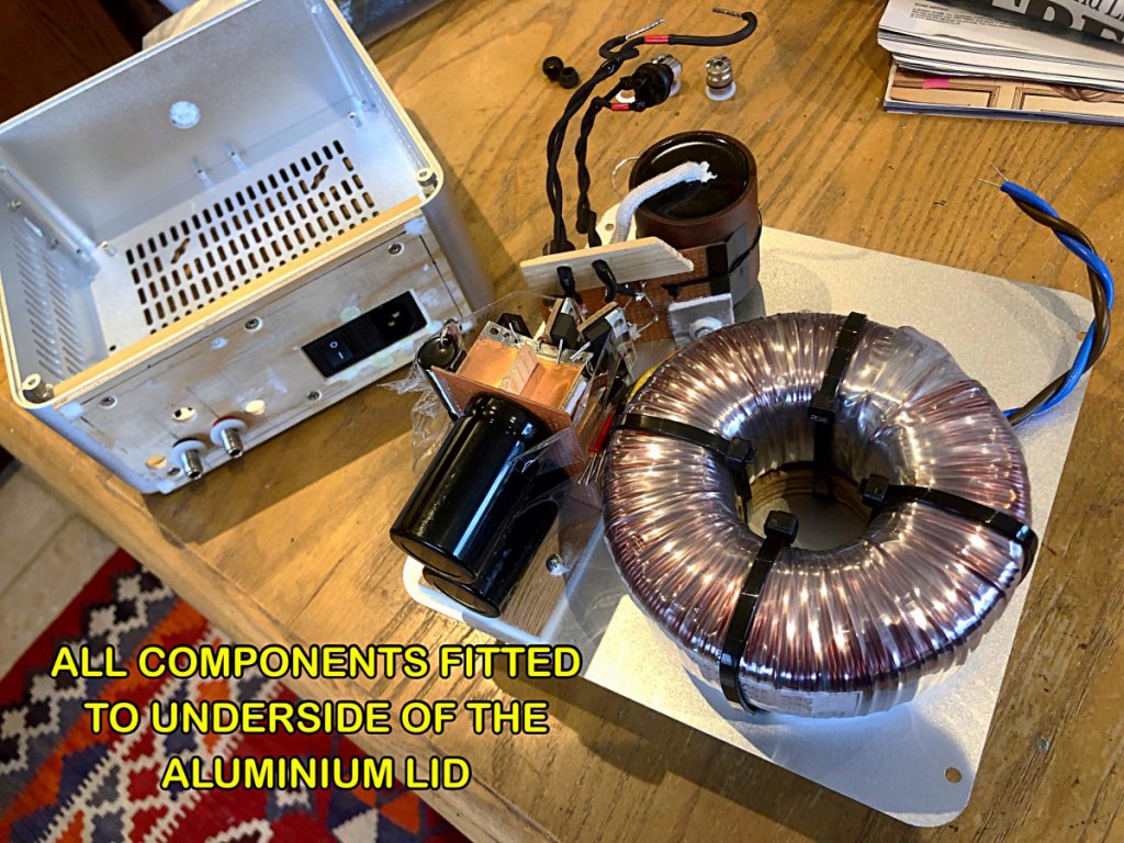

Thanks. The amps produce 35 Watts into 8 ohms. But the best news is that they run as “COOL AS A CUCUMBER”. No matter how hard you push them; THEY HARDLY GET WARM!!  However; bearing in mind the fact that heat rises; The lack of overheating in my amplifiers can be attributed to the circuit layout, where all components have been fitted onto the roof of the aluminium chassis ((ie. the underside of the lid)), with sufficient space and open ventilation available inside the unit. Not forgetting the big circular heatsink fitted on top. Also the larger gauge wiring and the wide copper foil strips in the rectifier, which help to absorb the electrical current.

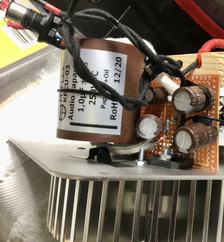

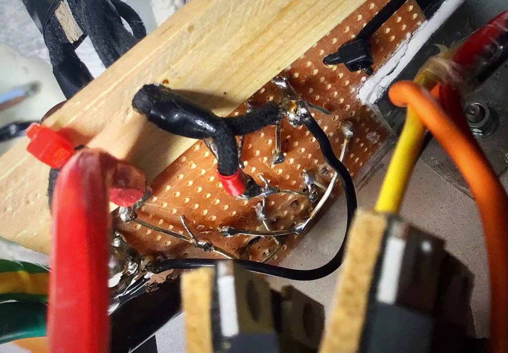

Point to point wiring…

Simple layout. Not pretty, but does the job…

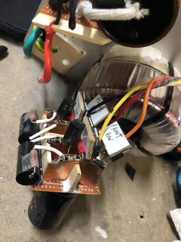

Rectifier wired up…

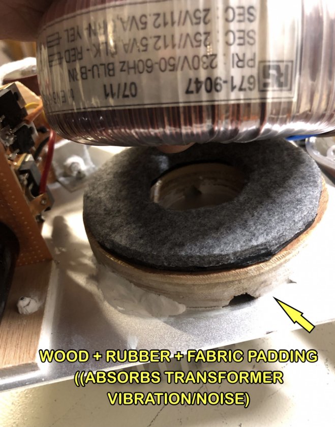

Isolation Platform for transformer…

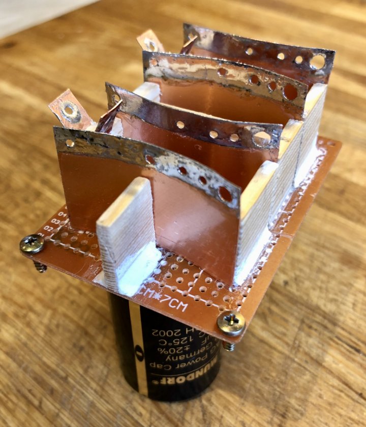

Rectifier board layout…

Direct signal contact to the internal wiring…

                     Rectifiers are Fairchild Stealths, as recommended to me by Jeff. I understand that they are up there up with the best. I spent ages using a set of tweezers and pliers to carefully bend/curve the legs; which allowed them to be slotted into the holes of the Goertz M2 copper foil strips.

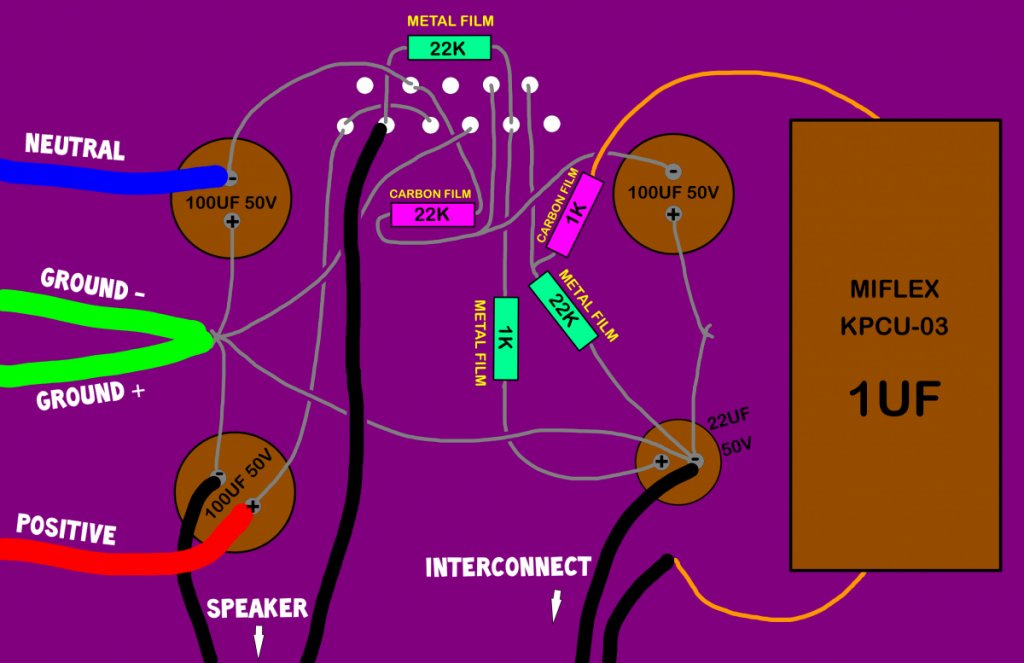

Here is a simplified version of the schematic for the ‘Main Board’. Some modifications were done to the layout; to keep the electrical pathway as short as possible, while maintaining efficiency and safety…

I'm interested in this design and I'm able to understand most of it between photos and explanation. However, I have a couple questions.
In the above layout diagram with purple background, what are the white circles? I see location where only one component connects or dead-ends, while another component connects on one end to two circles but nothing else. What do these circles represent? They don't seem to correlate to ground, or to being individual terminals.

« Reply #19 on: 28 Dec 2022, 11:08 pm »
White circles are the pins of the chip. It's a standard 15 pin multiwatt layout.
