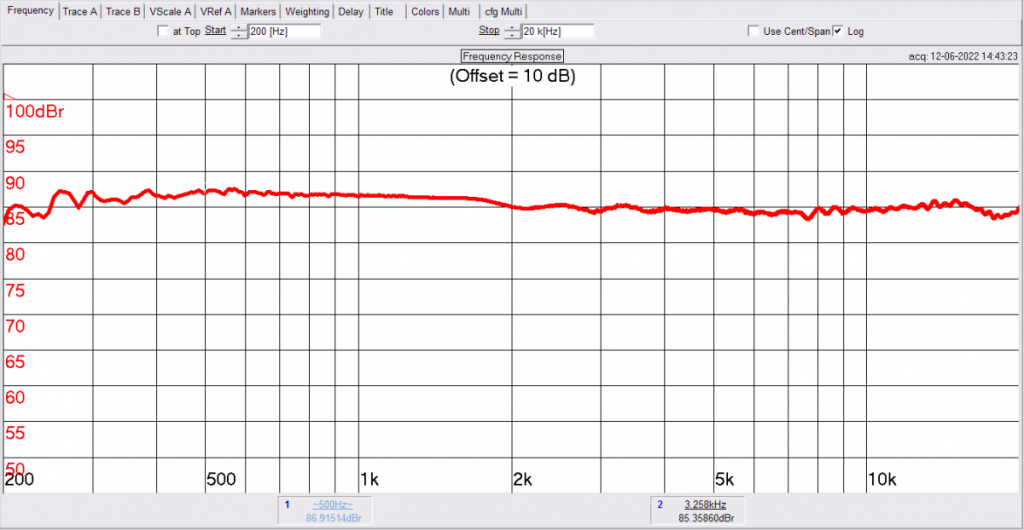

The drivers Jim selected for the BePure series are probably the best behaved units available.  Here is the on-axis response of the new BePure1.  Final voicing of the highs involves a lot of listening and discussion between Jim and me, but I've started this design off with slightly shelved down highs to avoid any brightness in rooms with lots of hard surfaces.  We may twiddle with the resistor settings, but you can see just how smooth these drivers are.  This is about the best I've seen:
