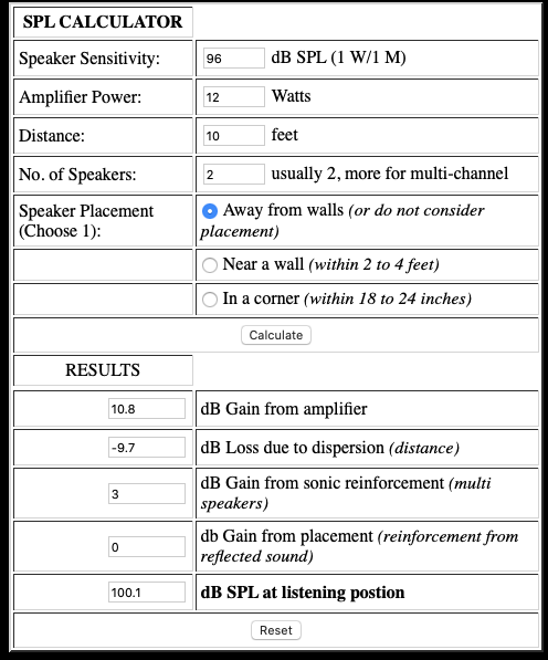

The sensitivity of the Apollo 11 is 96db with 1 watt at 1 meter. At 10 feet away from the speakers you can drive them to over 100db with 12 watts. So, it's NOT the wattage of the amp. It's the quality of the output transformer and power supply in that amp that can't keep control during complex passages. There is a common misconception that MORE power means better sound. A lot of times it's how the amp is made. I would look for a 10-15 watt SET amp that weighs over 80lbs which usually means very beefy/stable transformers (just a very rough place to start) Here are the calculations:
