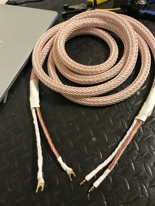

Here's an order i put together today. Customer ordered spades and bananas.
Build starts off the same by separating the two different colored strands.
Next step is a couple of clean twisted legs. Notice both legs are twisted to the interior of the cable.
Trim them to 6in and ESR paper is installed on the split at the bottom if you have some.

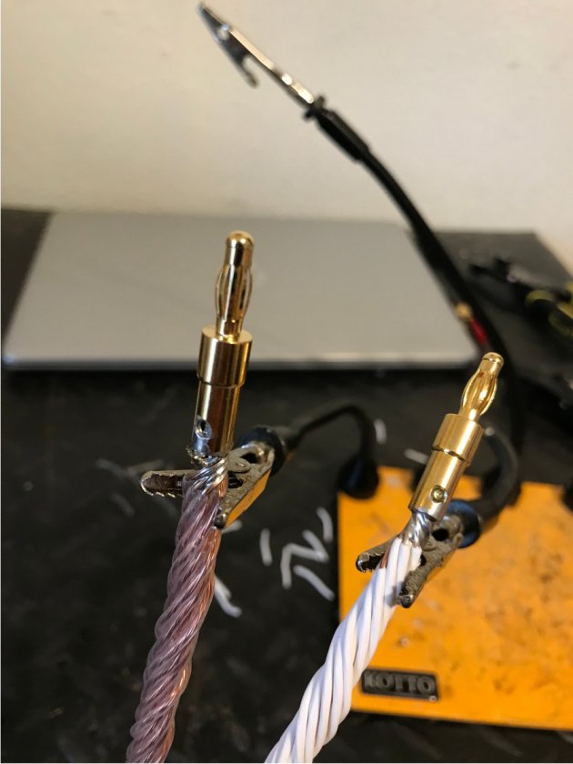

When installing tube connectors or banana plugs are the 24 strand cable sometimes you have to pull a few strands out in order to get a snug fit.
Those extra strands can get wrapped around the base.
Solder the banana plugs on.

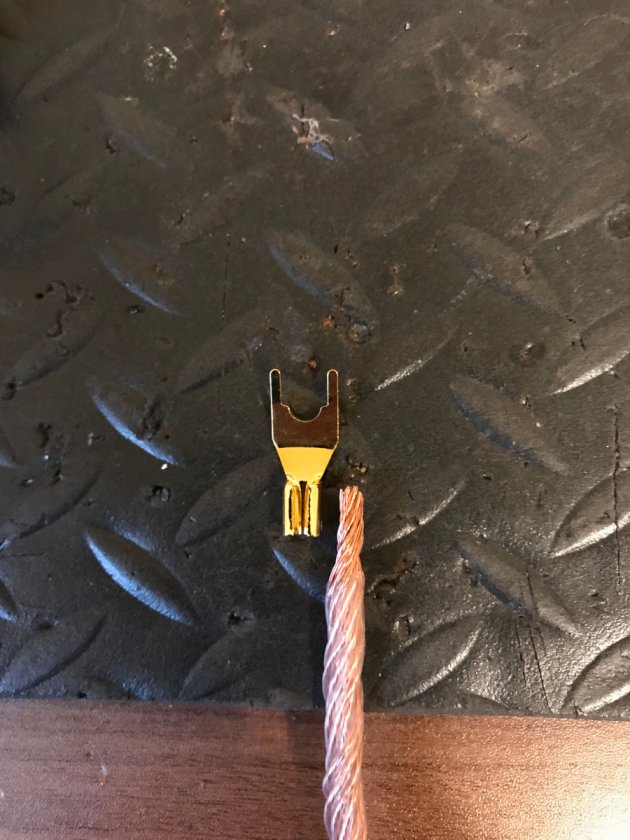

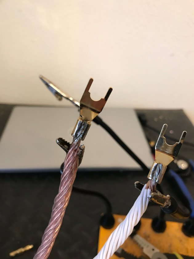

For spades i strip the wires about a 1/4in back so no excess sticks out the front of the connector.
Solder the spades on.
Final step in heat shrink. Large piece goes on first at the bottom, then the smaller pieces on the legs.
At this point they are done and ready to ship!
