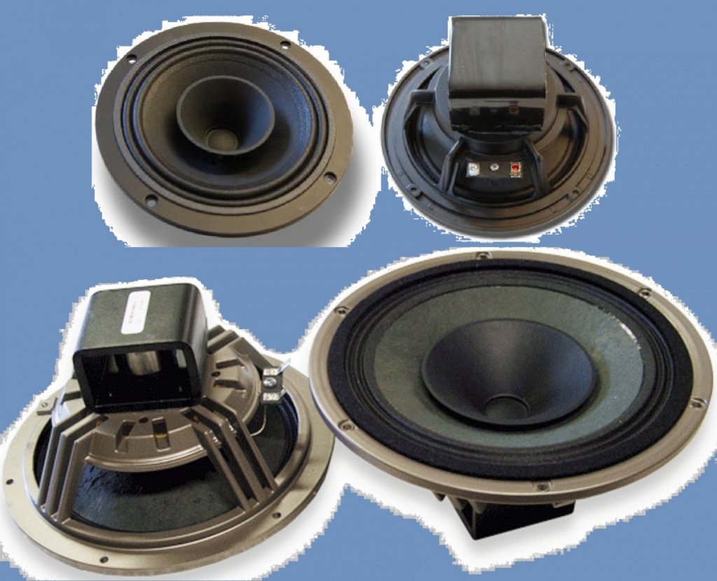

Greetings all!
I have had a pair of CAMs for years that I love quite a bit.
I drive them with flea-level power.
We moved a while back, and the volume of my new room is 3x maybe 4x the old room. I find myself pushing the amplification too hard now and then. I'm asking a lot of the little fleas.
I was looking into the Super 8 XRS instead since it's a more efficient driver - 98db sensitivity vs. 94.5db on the CAM.
Wondering if anybody here has made the move from the alnico to the ferrite magnets and what they thought of the change in sound.
Any feedback appreciated!

I’m a long time CAM owner as well. Like you, I’ve been very curious about the 8XRS. Note, I’ve had the 3XRS and the 3HO wide baffle monitors in the past. I really like the little RS5 driver a lot. The description of the RS8 being like a larger RS5 seems like a real winner to me. It’ll sound different than the 6” Alnico, no doubt. If I were to guess, it likely sounds more exciting and dynamic than the 6” Alnico.

I know I’ve posted comparisons in the past.  I’ve got RS5’s,  8xrs and the SAM’s.  Quick comments.  The SAM’s have a lovely tone about them that the 8’s and rs5 don’t have.  The bass on the SAM’s is, for lack of a better word, kind of tubby sounding…in a good way.  I think the bass on the 8’s does go just a tad bit lower, but the fatter sounding bass on the SAM will make it sound initially like it goes just as low as the 8’s.
I suspect that frequency response of the 8’s are flatter than the SAM’s, but it’s just a subjective opinion.  Some will like the slightly “U” sounding curve of the SAM’s and some may prefer the 8’s.  Neither one is better than the other.  The 8’s to me definitely sound like a big brother to the RS5.  Also, the Alnico in another cabinet will undoubtedly sound different than it does in the SAM.

Currently no more available as raw speakers.
I was lucky enough to buy a 7A now named 6xrs.
Great Alnico sound, perfect Qts to fit Frugal Horn.
The hemp paper cone factory gone,
so those rich harmonics no longer.
OMEGA 7A SPECS
Re - 7.2 ohm
Fs - 43.585 Hz
Sd - 134.782cm2
Md - 2 grams
BL - 4.971T-M
Qms - 2.030
Qes - 0.430
Qts - 0.355
No - 1.186%
SPL - 93dB
VAS - 63.770Liters
Cms - 2.47 2m M/N
Krm - 242.164 ohm
Erm - 0.979
Mms - 5.394 grams
Mmd - 4.494 grams
Kxm - 20.332 mH
Ekm - 0.585
WOOD HOLE 14,9cm
