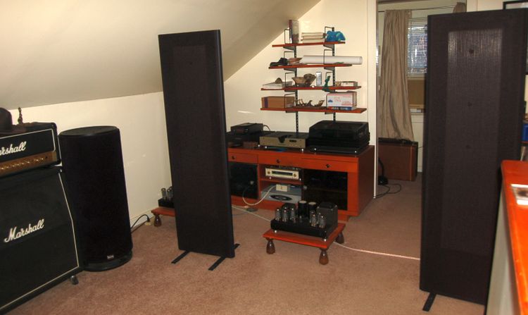

I'm using a similar powered VTL amp with LRS speakers in a small bedroom, that's plenty of power for that application.

Thanks. The room is 13' x 18', though the effect is that of a garret, with the upper half of each side wall (the long walls) pitched with the roof. To my surprise, the Maggies sound great in there.

Okay, sounds like my upstairs system.
You might run out of steam unless your listening is nearfield.
Keep the sub, maybe keep the Bryston for when you want to crank it up?
FWIW, I'm using VTL MB250s with the 1.7s.
