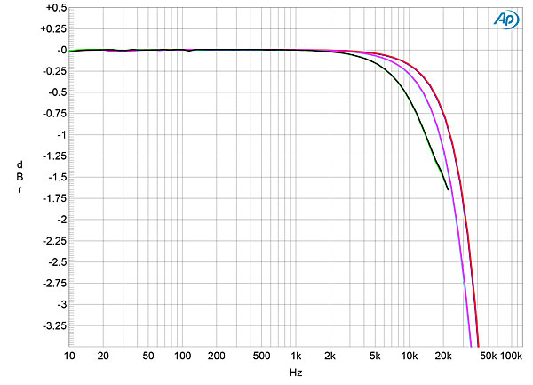

The Holo Audio May is unique in that is uses gentle filters to begin with, no brick wall digital filters, so aliasing is less of a problem. I have found that 44.1 kHz sounds more rolled off than perhaps my previous DAC, but hard to say because doing a quick A-B comparison would be crazy to attempt with too many variables. The old DAC doesn't have USB so there would be a SPDIF converter and cable in the loop.
John Atkinson's frequency response measurements in Stereophile show the May is down 1 dB (or more if aliasing is included) at 15 kHz, I can hear it. For a bright sounding stereo this is a good thing. For an old woodworker, not so good.
The 192 kHz frequency response is only down 0.35 dB at 15 kHz. That is all upsampling does, it allows for a more accurate filter to be used without changing the data.
The extended high frequency response shows up in shimmering cymbals and bells. Because the HQPlayer's filters are extremely accurate low level information is no longer hidden by noise, acoustic spaces are larger and performers are more 3-dimensional.
Fig.7 shows the May's frequency response in NOS mode with data sampled at 44.1, 96, and 192kHz. All three responses start rolling off in the top two audio octaves. With 44.1kHz data (green and gray data), the rolloff reaches –1.5dB at the top of the audioband, but the measured level is adulterated with aliased image energy. The actual rolloff is probably closer to –3dB at 20kHz (see fig.16). The response at the higher sample rates is down by 1dB at 19kHz (96kHz data, cyan and magenta traces) and 22kHz (192kHz data, blue and red traces)
Fig.7 HoloAudio May, NOS mode, frequency response at –12dBFS into 100k ohms with data sampled at: 44.1kHz (left channel green, right gray), 96kHz (left cyan, right magenta), and 192kHz (left blue, right red) (0.5dB/vertical div.).
https://www.stereophile.com/content/holoaudio-may-level-3-da-processor-measurements
