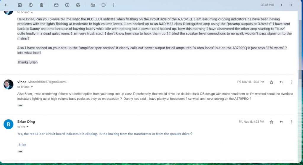

I also posted the exact explanation from brian regarding what the red LED lights are telling you, and it is not the amps clipping. Please try reading it again.
"The two red LED on the power amp board indicates the power rail has temporarily switch to high voltage rail: one LED for each power rail. When it is off, it means the power rail stays at half voltage rail to save power. These two are debugging LEDs to make sure when there is no signal, the power rails should be at half voltage level and when high demanding signal comes in, they can switch to full high voltage so that it has the correct max output. Older class A/B based A370 amps do not use rail switching and therefore does not have these two lights. If I have to guess, I would say the amp will begin to switch to high voltage rail when the output is about half to a third of full max output which is about 6-9db."

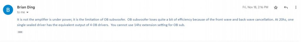

These amps clip on high level bass peaks "period" with an OB design. You can say whatever you want about that. I have asked the owner/designer himself regarding these amps, they are clipping. Brian has his PhD in Electrical Engineering and has explained to me as I have posted pages ago, the problem is the OB design is taxing the amp clean out of any headroom it would have had in a sealed design, (this is a fact).
You previously stated Brian never called the LEDs indicators of clipping.  Danny explained what Brian told him.  Why do you persist claiming the amps clip?
At high levels due to the front/back wave cancelation effect (Physics) again.

Please provide a quote from Brian that the LEDs indicate the amp is clipping.

I am not sure why Brian would explain to me exactly what the LED lights are indicating, then tell you they indicate clipping. From the testing I did with my amp and yours I can confirm that the LED lights do not indicate clipping.
Brian is also incorrect regarding how much output a sealed woofer has verses dual OB woofers. I have measured the outputs of both and I'd say that a single sealed servo sub has the output capability that is about 2/3rds of a dual OB woofer in an H frame enclosure.
If you don't get 100db plus output levels flat to 20Hz using low damping and the 14Hz extension then something is not wired properly. You amp will also drive the woofers to those levels without clipping. It just did it in my room.

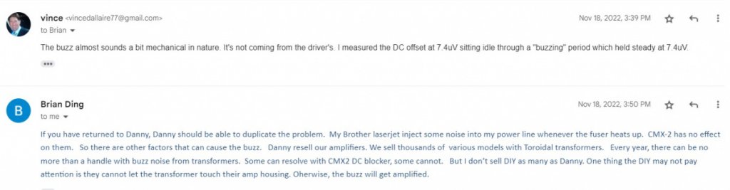

The OP previously indicated that the Sub Amp was noisy.  Question to Danny.  Did the amp returned to you make any type of noise.  Transformer hum?  Any hiss, hum or other noise from the speakers with just the amp turned on?  Would not expect a well designed amp to make any noise when powered on and with no input signal.
If Danny heard no noise from the amp when plugged into normal residential 120V, and the OP does.  There is a problem.  Nobody wants to have a possible problem with their electric service, but it does happen.
Previously there was a question about whether the amps were configured for Open Baffle.  Ignoring markings on packaging which could be wrong, is there a physical feature of the amp that can confirm the configuration?  Yes, they did work as expected for Danny.  Another means of confirmation might be good to identify.

I can say I've never heard a peep from any other class A/B amp in my house. Just these. Danny never mentioned anything with regards to 'buzz" I'm assuming that's fine at his place?

Danny, when you say the amps did not clip, by what means are you checking for clipping ?
