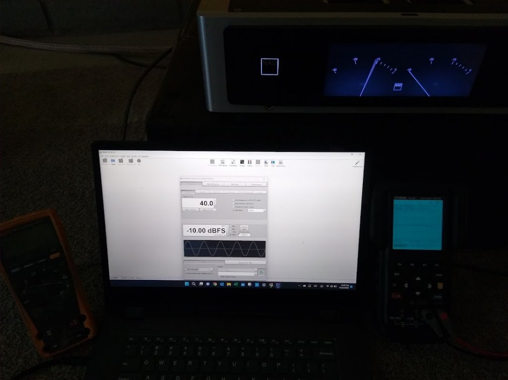

« Reply #260 on: 23 Nov 2022, 07:37 pm »
Okay, got a moment to test for clipping on the M33 at the "pre-outs" full tilt main volume at 40Hz and NO clipping at pre amp outputs.

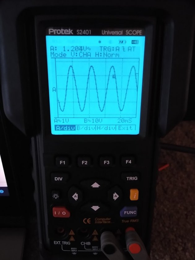

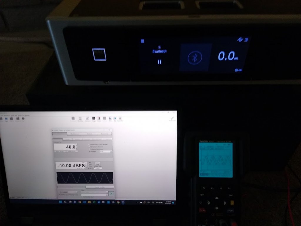

« Reply #261 on: 23 Nov 2022, 09:11 pm »
The voltage is lower than expected on the scope coming out of the pre amp out's ? Subwoofer outs, put out 1V but pre amp outs should be 3.9V. Input to the pre amp inputs on M33 says-( LINE IN, Input Sensitivity 280mV(ref 500mVout, Volume maximum))  (Maximum input level 2Vrms/8Vrms (low sensitivity mode)).

« Reply #262 on: 23 Nov 2022, 09:37 pm »
Those that can't see the reading, it's 15.3mV on the SC right before clipping it's output. perhaps I need to dig out an old interface that's capable of delivering more input voltage to the pre amp inputs.

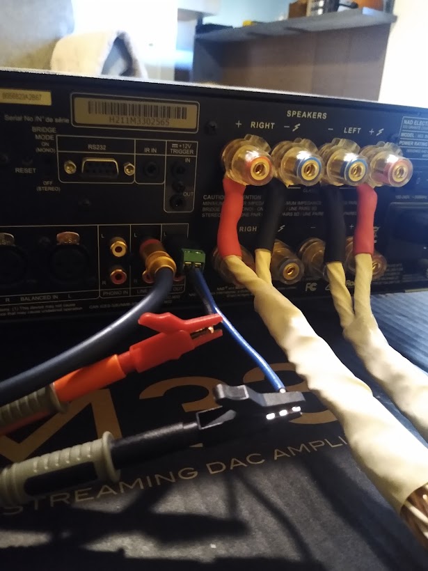

I didn't have any luck with the plate amp passing the high level signal to the main speakers at all.
Looking at the way you had it wired, you had the mains coming off the right channel line in, and with NAD feeding the left channel line in. It isnt a pass through, you are supposed to run another wire to the plate so its in parallel. It also looks like the crossover dip switch is in the middle, which is the AVR/LFE setting for an external crossover. If you were using the line outs, and havent changed that setting since you were using the sub outs, then you are sending a hot full range signal unfiltered to the plate which I would imagine it would not like.

« Reply #276 on: 29 Nov 2022, 11:56 am »
Thanks for pointing that out. I have never used the speaker level inputs before and no info on Brian's quick guide for this specifically. It's all now reconfigured with treatment in a different room now.
