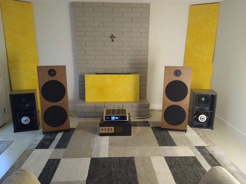

Your picture is of a pair of spatial speakers in a completely untreated room, or at least nothing on the front walls, corners, or immediate sides.
Open baffle speakers really need to have a front wall that is almost covered in something that will break up and/or absorb the back waves. Those corners really need some traps too.
I recently heard some Spatial X4's in a treated room, and then in the same room with all of the treatment removed, and with all of the treatment removed it was completely un-listenable. They were unbearable at any level over a normal speaking voice level.
So I can't help but think your room is as large or even a larger problem than your issue with not having bass output from the servo subs.
I would highly recommend corner traps, wall panels (absorbers), and diffusers to cover most of the up front area.

It's funny you say that Danny. I moved everything into my fireplace room, long rectangular room. Just threw up a few panels to kill the zingers ! Sounds much smoother after analyzing and correcting with REW. Kicked Dirac to the curb for now as it is pretty darn smooth now without Dirac. However the amps perform the same. Room treatment can't reduce circuit overloads in electronics.
